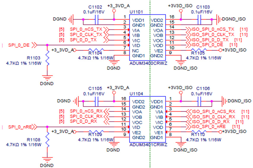

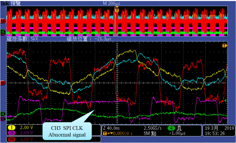

We use the SN65HVD78 device, there is a state of abnormal operation. (As shown below)
SPI_CLK_A/B signal, the converted CLK will be one less (red circle), which will cause our data transmission error.
Please help provide your suggestions to solve the problem. Thanks for kindly help~

    3.What's the load of the receiver output?
    A : I am not quite sure about your question. The architecture is as shown below in SPEC.
    4.What's the state of the device?
    A : Output CLK signal abnormal. Please reference on below.
    5.Can you plot differential voltage of the bus (A-B)?
    A : Please reference on below.

    What cable do you use? Is it twisted pair? Can you try using 1kOhm or higher for R1112/R1114? Do you know why the common mode oscillates around 3~4MHz? Can you check if node 2 has the same issue? If node 2 is OK but node 3/4 has errors, it might be a noise issue. If node 4 as the master, how would node1/2/3 work?

    I would like to ask the difference signal of A in the figure below is relatively poor. But can get the CLK. The signal of B is better, but can not get CLK. What is the reason? Thanks for help~
    A : UL20276#28; yes it’s twisted pair.
    A : We will try this.
    A : It might be produced by AD phase
    A : Node 2 is OK. No this issue
    A : The node setting in our system is fixed, but we change another board to confirm it would be ok or not, but the result is still occur error.

    When you compare the input signal with the output, You may need to take propagation of the cable into account. Usually the cable has 5ns per meter delay. For 12 meter, the delay is about 60ns. I was wondering if it's possible that the received error at B comes from the input of A.
