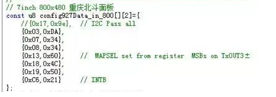

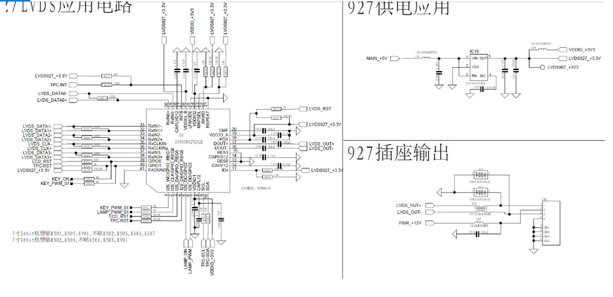

Hi expert:
My customer use 927&928, there are some white spots appear on the screen when it is turned on. But there was no problem when they used 927&926.
They use STM32 at the screen end. We adjusted the PDB signal timing which is controled by a processor, and the result is better, but not completely resolved.
The test video is attached.Please help to check the attachedsch and code about 927.
Any Suggestions are appreciated
