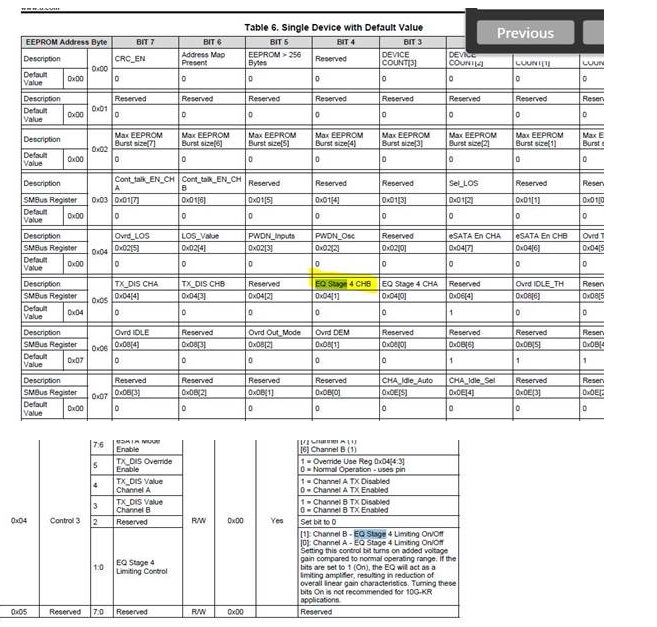

Can you provide some information on what this setting is doing "EQ stage 4 enable / disable"?

Turning this bit on, forces equalizer stage 4 to operate in limiting mode. In this case, the output is either zero or one(signal is getting digitized). On the other hand, if this bit is set to 0 then it would operate in linear mode and passes signal training sequences to pass through. In this case, device operates like an analog buffer. In applications where there is signal training going through the device, this bit needs to be set to 0.
