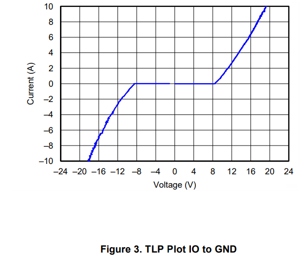

(1) I did not find in the datasheet the information about the clamping voltage for 16A, which corresponds to the 8kV IEC 61000-4-2 waveform.
TLP Plot only goes up to 10A.
