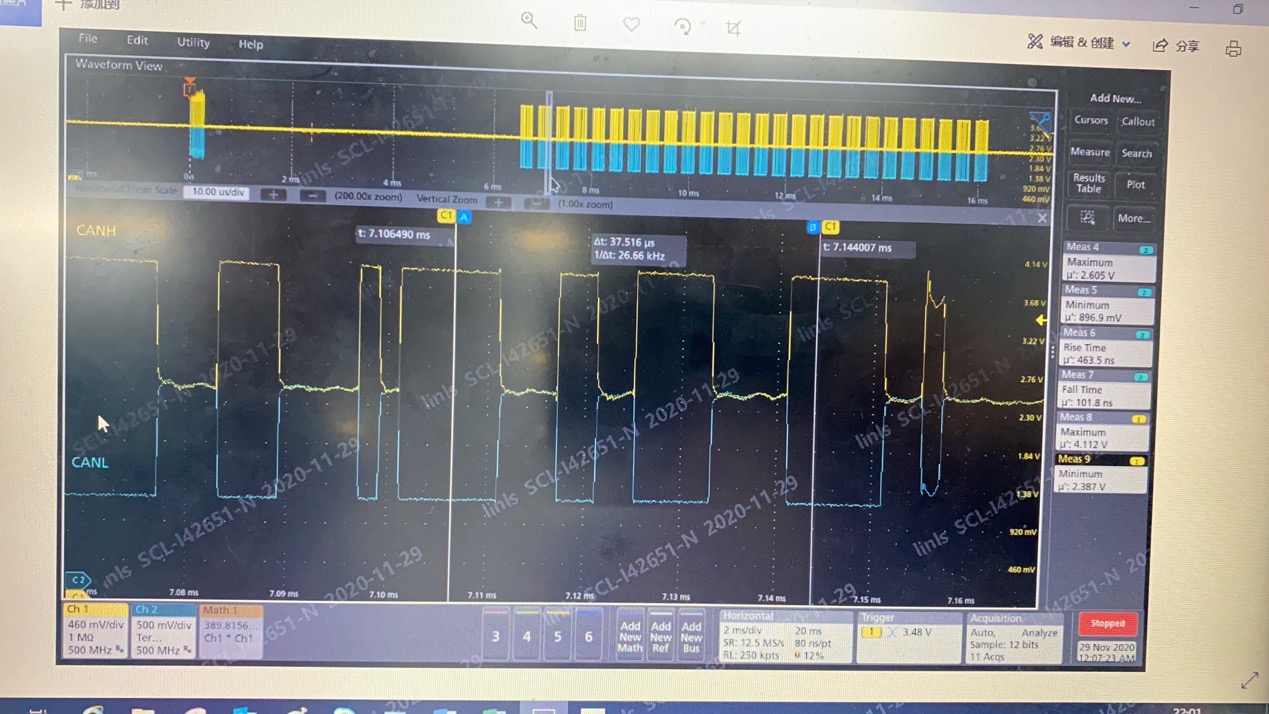

Customer is using out TCAN1042HV, and they found that at the end of each message, the signal of CAN bus would be lower at the final bit, which can be seen as below:
And the CANH/L waveform can be seen as below:
Wish to get your reply as soon as possible. Thanks!
  • Miles,
    This is interesting, because typically it is the opposite: the bit at the end of the CAN frame has a larger amplitude because multiple devices are sending the ACK bit at once to the bus.
    • How many nodes are on the bus when these waveforms are captured?
    • And this is at the end of each CAN frame?
    In general, the voltage differential is still high enough that it will be interpreted correctly by the controller through the RXD pin. However, we still need to understand why this is happening.
  • Hi Eric,
    Reply for your questions are listed as below:
    1. Only two can devices are connected to CAN bus, and one is battery pack and another is connected to computer through TCAN1042HV;
    2. Yes, this is the end of each CAN frame, which can be seen as below:
    Is that a ACK bit? And is there any communication issue caused by this situation?
