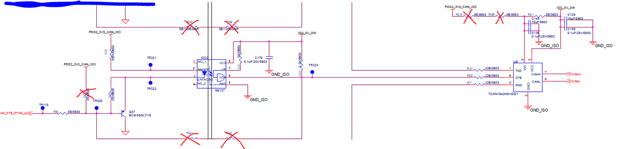

    Attaching a section of datasheet where it has been mentioned VCC not needed in STANDBY mode and only VIO is needed. In our schematic VCC=VIO=5V always.
    I have attached a section of the schematic and marked the components that are not mounted with a red cross.
    Please let me know if you have any other queries.
    Rohan
  • Hi Rohan,
    It doesn't appear that there's any way for the circuit to drive the STB pin of TCAN1042 to ground potential. When the optocoupler is not active, the external 3.3k-ohm pull-up resistor keeps the STB pin biased to ISO_5V. When the optocoupler is active, it similarly drives the line potential to ISO_5V. If the intent of the design is to put the transceiver into normal mode (STB pin low) when the optocoupler is engaged, pin 7 of the optocoupler can be connected to the GND_ISO net.

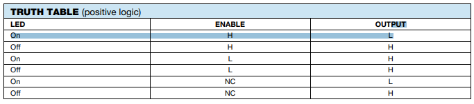

    We are facing an issue of not being able to drive the STB pin to ISO_5V when the opto is switched off. We are able to drive the STB pin LOW when the optocoupler conducts. Attaching truth table for 6N137. We are using it in Enable HIGH configuration. Is there anything else that can force STB pin to remain LOW?
    Rohan
  • Hi Rohan,
    There is no internal structure in TCAN1042 that would be attempting to keep thing input low. The weak pull-up should be attempting to default this state to high, so it's puzzling to hear that with this and the external pull-up the device still doesn't go to standby mode.
