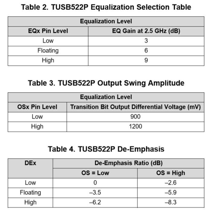

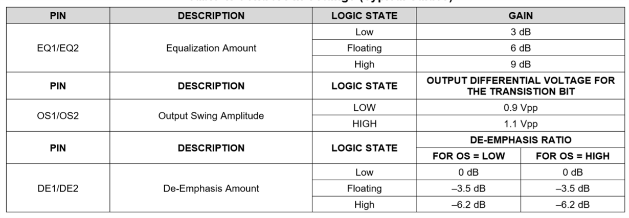

Hi I'm Trying to make Hub Chain Board.
TUSB5222 DataSheet has different Table in TUSB522EVM datasheet.
Look at the picture which i posted.
this is TUSB522 DataSheet Table
And This one is EVM Datasheet Table.
which one correct things?
