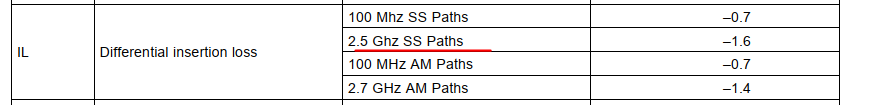

In the datasheet, HD3ss460 is compatible with 5 Gbps USB3.1 Gen 1. But we only find the differential insertion loss at 2.5GHz. Do you have the data at 5Gbps? Thanks.

You will want to refer to the 2.5 GHz data. 2.5GHz is the Nyquist of 5 Gbps and corresponds correctly.

Would you please give more detailed explanation about this? I am not very clear about this answer. Actually we want the insertion loss info when the transmit speed is in USB3.1(5Gbps).
In short, a signal with a 5 Gbps data rate is that same as a signal with a frequency of 2.5 GHz. Data you underlined above corresponds to 5 Gbps.
5Gbps is the data rate measuring the transmission rate of a "bit". One bit is only 1/2 the total period of the waveform. If you were to measure the total period of the signal and take the inverse of that period, it will give you 2.5 GHz.
