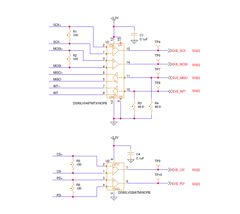

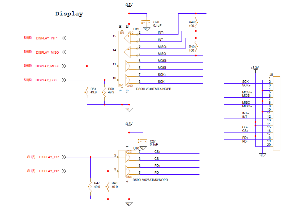

I'm using the DS90LV049 to send a SPI bus across a ribbon cable to a remote display. I have the DS90LV049 chip on both boards to send and receive the SPI. I'm using a 3M 3365/20 ribbon cable with 100ohm terminating resistors. I'm testing with a noisy AC environment and it is causing issues for the data being sent to the display. When the cable is short ~5" the noise is not a big problem but when I go to a 12" cable then the display starts to get bad data. The schematics are attached, and I added a 0.001uF cap to the power supply pins of the chips which helped reduce the noise for the short cable, but it did not help with the longer cable. The 50ohm pull downs are DNI since our processor could not drive that load. We are running the SPI at 8MHz which works fine in a non-noisy environment for distances up to 10ft. Any suggestions on how to mitigate the noise coming in through the cable? Do I need to add more caps to filter the power pins? I read through the "How to Terminate LVDS Connections" TI app note and saw Figure 2:
Would this termination help get some of the noise out?
  • Power/ground lines between the signals help against crosstalk; you are already doing this. The best protection against external noise would be twisted pairs, and shielding.

    The display is still getting some bad data, but I haven't ruled out that the noise could be coming in through the +3.3 and GND wires. The +3.3 is oscillating on the display board some so the data getting corrupted after it reaches the board. (+3.3 is green trace)
