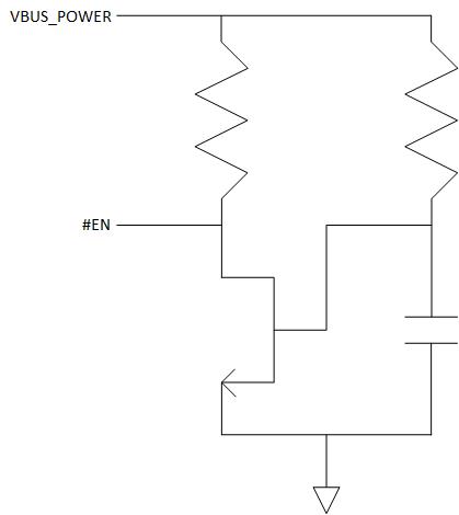

  • Ann,
    In order to have the TPD4S014 do what they want to to, they will need to apply a circuit similar to this one between the VBUS_SYS output pin and the /EN Pin.
    This circuit, when sized correctly, will pull the /EN pin high then low long enough to meet the internal reset timing.  This will make the TPD1S414 do what your customer wants.

  • Ann,
    In this case, the customer will not use the circuit I showed, and must add a weak pull-down resistor on /EN to ensure that the switch will be enabled without power being applied internally.

  • Ann,
    If the /EN pin is truely floating, then the gate of the power device is not determined. The system is designed so that if the /EN pin is grounded, then the switch will be closed and if it is pulled to a voltage greater than 1.2V, then the switch will be disabled. Does your customer have a power supply that will be active in the case that you want to block VBUS_SYS? If they do, then the can put a pull up resistor to that supply from the /EN pin to ensure that the fet is disabled.
    Chuck

  • Ann,
    /EN should be held low to enable the switch and pulled high to disable to switch. There is some internal circuitry to the chip that will not be properly reset unless EN transitions from high to low.
    We cannot guarantee functionality of the part if /EN is floating.
