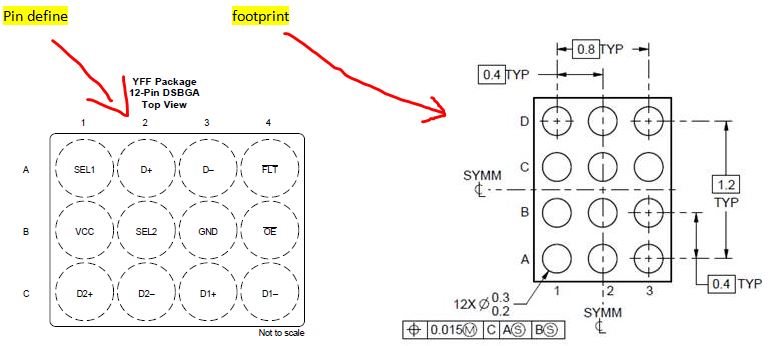

Hi All,
To compare PIN define and footprint picture as below, seems like not make sense, A,B,C definition are different about them. could you help to know that correct footprint for customer layout. thank you.
thanks you.
Mark Chen
