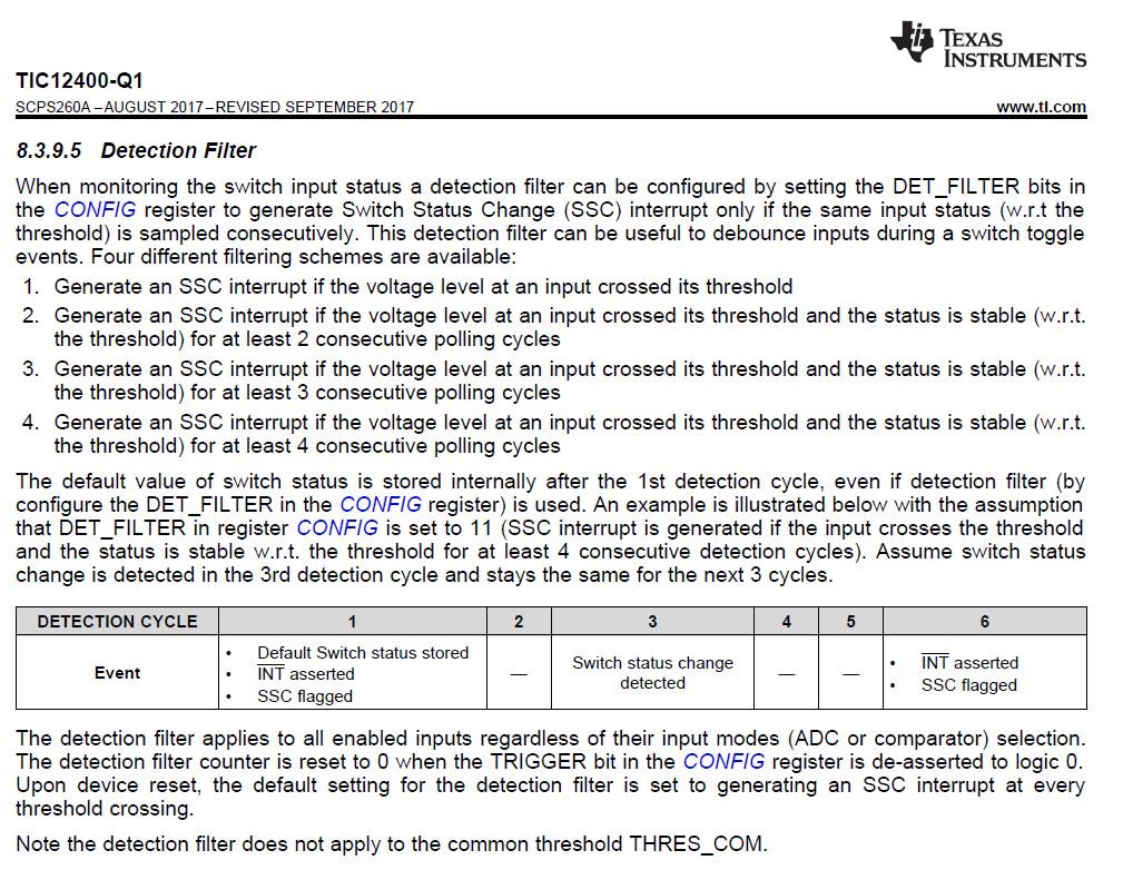

Is there any chattering spec for each channel input of TIC12400-Q1?
That is, how long does the input above threshold must be held to be recognized high or low? On the contrary, how short can the input be ignored?

    The TIC12400 has a detection filter where you can adjust the sensitivity of the device to "chatter".  You can define how many consecutive polling cycles the input needs to be at the same sate before an interrupt is generated.  More information can be found in section 8.3.9.5 of the datasheet.
