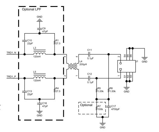

Hi team,
could you help to share the LPF circuit parameters for 811s, especially for L3 and L5, what are the recommended part number of it? And how about the power level for the caps and resistances?

We have evaluated this part for 0402 size capacitors and resistors, these are not high power components. The component values used can be found in section 9.2.1 of the datasheet and the following components and vendors were used:
LQG15HHR12G02 - Murata
0603CS (1608) - coilcraft
