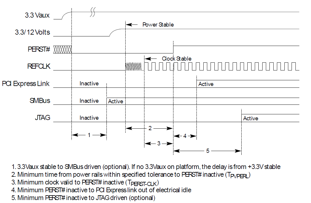

We want to check the meaning of the time tPOR. Could you please use a picture to describe it? Thanks.

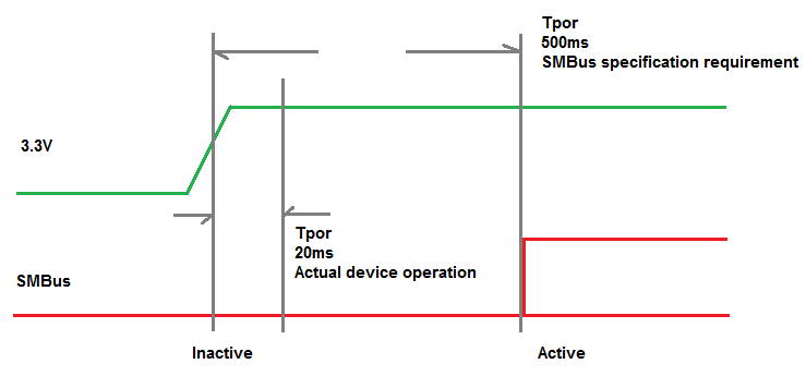

You mean the time is 1 or 2 in the picture? If it's 2, what's the 20-30ms meaning?(The datasheet data is below 500ms). For 2, it also mentioned min time from power rails, if it's 500ms, 20ms maybe too small here. Thanks.
