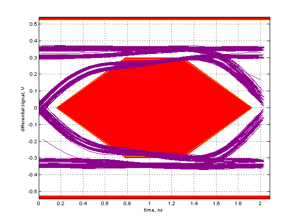

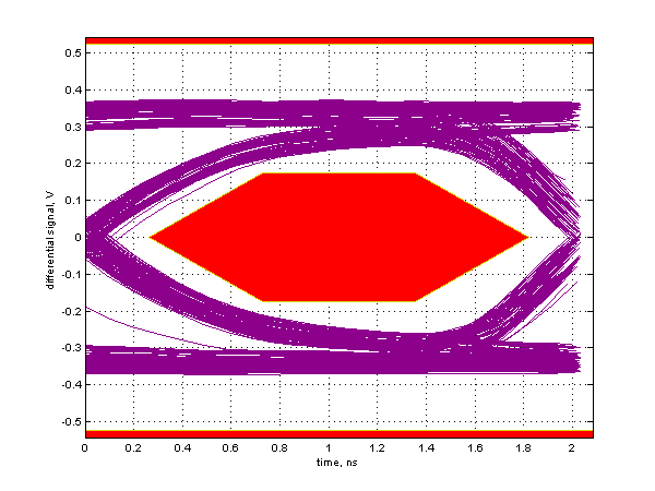

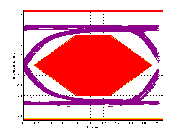

    2. About the eye diagram, jitter, and frequency shift issue. When we enable TUSB212, even TUSB212 can enhance the eye diagram, but it also make the jitter become worse, and also may cause USB signal rate to over the spec.
    Source eye :
    Source connect to Puck board typeA and measure to host connect eye. We remove the TUSB212 in this test.
    Source connect to Puck board typeA and measure to host connect eye. Gain setting is DC_Boost is high, and EQ is level 3.
    Source connect to Puck board typeA and measure to host connect eye. Gain setting is DC_Boost is low, and EQ is level 2.
    When we put TUSB212 on the cable, we can obviously observe that jitter and signal rate are getting worse.

    Sorry for the delay, i had a illness late last week. I recommend using TUSB212 on with medium DC boost and level 2. Also there seems to be something on the Puck board causing an abnormal eye. Is there a schematic for the Puck board that I can review? TUSB216 should be used on the puck board. TUSB216 has greater re-driving capability on both the rising and failing edge of the eye, which could help in this case. Does the design have a I2C master available?  Is there an evaluation where the whole systems, puck board plus cable, is connected and measured?

    3.  TUSB212 will amplify some noise/ISI caused by the 5 meter cable. DC boost will increase this amplification and can cause variation in the data rate check. TUSB216 can turn off DC boost to prevent this.
    Looking at the schematic the customer should be able to use TUSB216 now. They will have Boost Level 2 and Medium RX_SEN settings.
