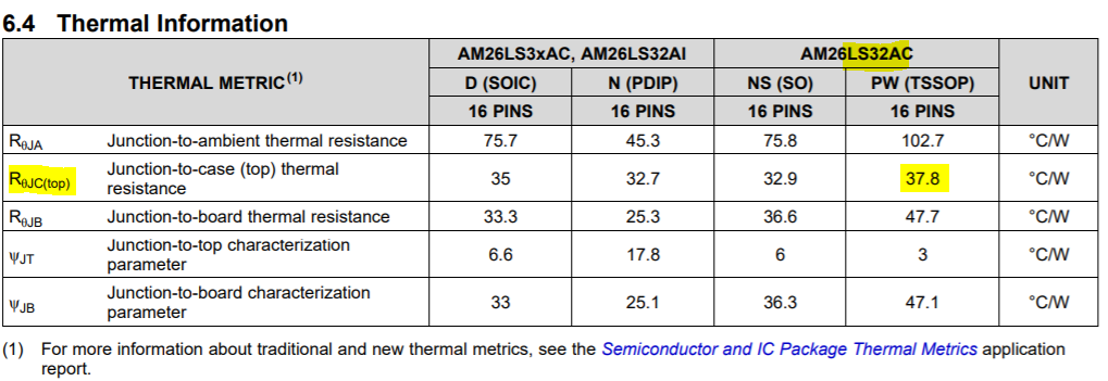

④ Thermal resistance: Rth_j-c (= thermal resistance between junction and case)  = 108 ℃ / W, is it correct?
In my own opinion, thermal resistance only shown in DS is Rth_j-a(= thermal resistance between junction and ambient) =108 ℃ / W.

  • Hi Eric
    Thanks for your kindly reply. I've got the latest datasheet now.
    Let me confirm two things as below noted ① and ②.
    I will use only 3 pairs of input.
    ①Regarding ”Input power when differential signal is added”,
       Since Ii is written "line input current" in datasheet, I think the total Ii for 1 pair of input will be multiplied by 2.
       That's why I multiply by 6 in total. Am I correct?
     →(2) Input power when differential signal is added: Ii(= differential input current) x Vi x 6 input terminals ※In consideration of margin, Ii is calculated not by pulse but by constant-on.
    ②Since I can get Rth_j-c from the latest datasheet, i should use 37.8℃ / W but not 108℃ / W for calculation, am i correct?
     →(3) {(1) + (2)} × 108 ℃ / W ※ Calculate by this method in order to take margin into account.
    Jo
  • Hi Jo,
    1) I think the total Ii for 1 pair of input will be multiplied by 2.
    Yes, each pin will experience the specified input current. Note however that this value is specified at voltages outside normal operating conditions and actual current through this pins during typical use will be less. Typical RS-485 signals will also have each line be inverted causing one pin to sink less current than the other. For your calculations, it may be prudent to assume worst-case to ensure fault conditions are also taken into account and give you a wider margin for typical operation.
    2) Since I can get Rth_j-c from the latest datasheet, i should use 37.8℃ / W
    Yes, the value for RthJC that pertains to the specific part number and package type can be used here. Because the conduction through the junction-to-case of the package can move heat more efficiently, this value is smaller than the junction-to-ambient thermal resistance. In reality, the device will dissipate heat both to the attached board and the ambient environment, so thermal relief will come from both of these values. For a rough approximation, you may only calculate the junction-to-case thermal resistance as this is where the majority of the device's heat will be transferred.
