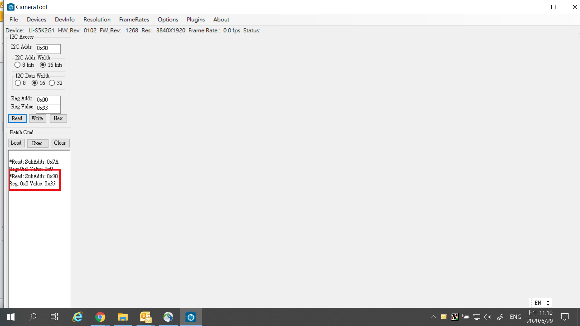

 We want to develop automotive surround system, so bought DS90UB953AEVM ,and Leopard Imaging USB board (LI-USB30-S5K2GI-FPDLINK3-025H).
But unfortunately 953AEVM could not been detected by Leopard imaging USB board.
I have asked Leopard Imaging contact window, but he said it needs TI to support this issue.
Could you tell me how to set up TI 953AEVM to Link Leopard Imaging USB board correctly?

  • Dear Nick:
     I can access Leopard USB board (I2C ID:0x60) from TI 953EVM  to run ALP.
    The Leopard USB board "CamerTool" also can access TI 953EVM I2C address is 0x30.

  • Dear Nick:
     I explained my test setup again:
    1. Leopard USB board with TI 954 and mipi to USB chip, so I can used their "Camera tool" software to show out video on NB.
    2. DC12V to Leopard USB board =>PFDLINK3 to TI 953EVM (with Syn. mode, power from coaxial cable)
    3. Leopard USB board connect to NB by type B USB cable, and run Leopard "Camera tool" software.
    4. NB another USB port  used mini USB cable connect to TI 953EVM and run ALP.
    5. ALP run pattern generated and fixed pattern, but Leopard USB board Camera tool didn't show any image picture.
    6. When I used Leopard camera module to replace TI 953EVM, and  the "camera tool" can show out picture.
    My question is : how to set up 953EVM to show out picture by Leopard "camera tool" software, as we connect to Leopard USB board?
    As below is my test result: it seems TI 953 EVM can detect Leopard USB board by ALP, and  Leopard "camera tools " also can read TI953EVM register correctly.

    As below is TI 954 register for pattern generate enable.
    [REGISTERS]

    Do you have the values for the indirect registers specific to the the pattern generator?  I only see the main registers and not the patgen registers.  Also it works for one port at a time but not together.  Is there a possible bandwidth issue?
    Nick
  • Dear Nick:
     Good news about you reply TI 953EVM one port can work with Leopard USB board.
    We bought :LI-S5K2G1- FPDLINKIII-025H & LI-USB30-S5K2G1-FPDLINKIII-025H
    Do you tell me detail how to set it up?
    Right now seems: Leopard USB board could not detect TI953EVM/
    About CSI register/ 953 register are as below.

    If you're not able to connect how are you able to pull these registers?  If the 954 is not able to connect to the 953 I would suggest first to verify that power is stable to the 954.  Also is there any configuration to use the PoC?  Also the pattern generator is enabled it will be sending the data over the link.  You should be able to verify this by looking at the line count register in the 954.  Were you ever able to get lock?
    Nick
  • Dear Nick:
    The test setup is POC.
    I checked 954 register 0x04 value is DF that is lock flag enable.
    May I know whether it needs other driver for TI 953EVM as Leopard USB board connection?
    If you look at registers 0x73 and 0x74 you will see the values are 0x04 and 0x38 respectively.  This value refers to the line count being received from the serializer which is 1080.  So since you are receiving lines and you have no errors it appears it is setup and working.  It also appears that in register 0x20 you are forwarding both ports to the CSI output.  Since you are not using any kind of synchronization I would suggest turning on best effort forwarding in register 0x21[1].
    Nick
