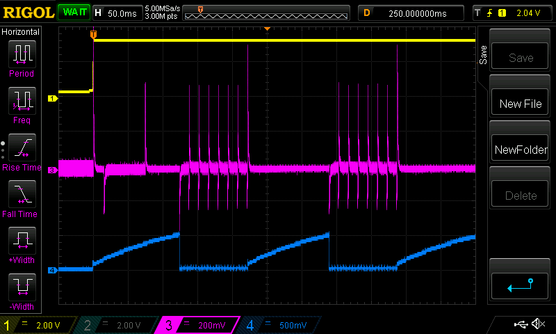

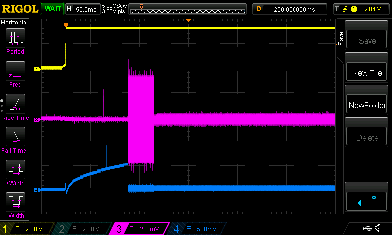

    I have tried multiple PCs with USB3.1 type-c ports and none work. I do not have a USB protocol analyser but have probed the TX1/TX2 and RX lines and measured the RX Detect waveforms. (Please See Attached zip file). I have also probed the same signals on my evaluation board setup for comparison. In all plots yellow is the 3.3V supply, and pink is the TX or RX positive signal. Reset for the TUSB9261 is released 25ms after the 3.3V rails comes up.
    TX1/TX2
    Plugged into the USB3.0 port I see the RX detect pulses then what looks like the polling signals. Attached to USB3.1 I see the RX detect signals on TX1 multiple times before the maximum number of attempts is reached and the TUSB9261 enables the USB2.0 pull-up. Measuring the evaluation setup I see the RX detect pass and polling occur afterwards. The shape of the RX Detect (see the captures labeled RX_Detect_Detail) is different between the eval board setup and the prototype. Which explains why this step fails.
    RX
    It appears that even attached to a USB3.1 port the PC can detect the termination of the RX lines at the TUSB9261 as it stops sending RX detect pulses long before the USB2.0 pull-up is enabled. And the shape of the RX detect observed (see Detail captures) is the same evaluation setup to prototype. It appears this side of the link is operating as expected.
    I am fairly certain that the multiplexer is switching correctly, as it is working when attached to the USB3.0 type-c ports. And flipping the cable results in a swap in TX1 or TX2 getting the RX-Detect signals. The issue appears to be with the termination observed by the TUSB9261 TX pairs. Perhaps your suggestion of moving from 470nF capacitors to 220nF and 330nF capacitors may help with this.

  • Hi Peter,
    I agree that changing the AC coupling should help here. It seems that the equivalent capacitance on the bus is causing a shift in common mode voltage and distortions in the RX detect from TUSB9261.

  • Hi Malik,
    I have been investigating the relative timing of the RX detect signals on the TX and RX lines of the TUSB9261. When connected to PCs that connect at USB2.0 the following signal behaviour is observed.
    The host PC starts its RX.Detect first. The RX detect signal pulses sent by the PC occur at consistent intervals before stopping. The pulses stop at approximately one of these intervals before the TUSB9261 sends its first RX.Detect attempt. As I see no evidence of the PC attempting polling my current hypothesis is that the RX detect of the PC is not stopping due to detecting correct termination but for some other reason.
    By the time the TUSB9261 sends its first RX detect attempt the PC has its receiver unterminated. Suggesting that something has occurred that has caused the PC to enter the LTSSM SS.Disabled state. Probably the same event which caused the PC to stop RX.Detect.
    My setup with evaluation boards connects at USB3.0 when connected to the same PC and I observe the signal behaviour below.
    The host PC also starts its RX.Detect first at the same consistent intervals as before. This time however these pulses continue to be sent until after the TUSB9261 has sent out it's RX.Detect. The TUSB9261s RX.Detect appears to pass the first try. The RX detect from the PC then appears to pass a couple of attempts after the TUSB9261 RX.Detect passes. After both of the RX.Detect signals pass I can see the polling signals being sent in both directions.
    So in summary the problem appears to be that before the TUSB9261 attempts its RX.Detect an event is occurring that causes the host PC port to enter SS.Disabled. Do you know of any particular failure modes which would show such behaviour?

  • Hi Malik,
    I have done a test to assess the termination of the PCs RX pins over time. In this test I have injected a 50mV 1MHz sine wave into the TX lines at the Type-C connector. This signal is fed into both the positive and negative wires through 5K resistors.  In the plots below the pink waveform shows the signal on the TX line. The yellow trace is the boards 3.3V supply. This supply comes us approximately 5ms after VBUS is a stable 5V. You can ignore the blue trace.
    When the receiver of the PC is terminated I would expect the sinusoid to not be visible as the resistance between by signal generator and the TX lines is much higher than the receivers resistance to ground when terminated.
    Connected to the PC that works the sinusoid I injected is never visible. This suggests that the PC has its RX lines terminated at all times (this matches the USB3.0 Spec). Connected to the PCs which are not working the sinusoid is visible to varying degrees over time. Before the TUSB9261 and multiplexer are powered the sinusoid is fully visible (suggesting the RX of the PC is unterminated even before my board powers on!). Then throughout the TUSB9261s various attempts at RX detect the amount the sinusoid is visible varies. This second part is harder to interpret.
    Any light you can shed on this behavior would be very helpful.
