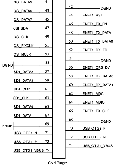

Dear experts,
We have a custom iMX6ULL board on an m2 form factor. It is plugged to a MAIN board which contains the DP83825IRMQR eth phy chip, the magnetics, and the eth port. The ethernet chip uses an external 25MHz oscillator for clock.
The problem we are having is that the network connection of the ethernet chip flaps (turns on / off)
    [  959.561827] TI DP83825S 2188000.ethernet-1:00: attached PHY driver [TI DP83825S] (mii_bus:phy_addr=2188000.ethernet-1:00, irq=POLL)
    [  961.624018] fec 2188000.ethernet eth0: Link is Up - 100Mbps/Full - flow control rx/tx

The connection of the DP83825 to the MAIN board is (sorry for the overlapping texts)
and to the m2 connector
While the connection on the iMX6ULL m2 edge finger is
to the iMX6ULL chip
Our device tree script in u-boot is imx6ull-prox-sodimm.dts (attached)
    &fec1 {
        pinctrl-names = "default";
        pinctrl-0 = <&pinctrl_enet1>;
        phy-mode = "rmii";
        phy-handle = <&ethphy0>;
        /*phy-reset-gpios = <&gpio1 5 0>;*/
        status = "okay";
        mdio {
            #address-cells = <1>;
            #size-cells = <0>;
            ethphy0: ethernet-phy@0 {
                compatible = "ethernet-phy-ieee802.3-c22";
                reg = <0>;
                clocks = <&clks IMX6UL_CLK_ENET_REF>;
                /*clock-names = "rmii-ref";*/
                clock-names = "no_enet_out";
                assigned-clock-rates = <0>, <100000000>;
            pinctrl_enet1: enet1grp {
                fsl,pins = <
                    MX6UL_PAD_ENET1_RX_DATA0__ENET1_RDATA00    0x000110B0
                    MX6UL_PAD_ENET1_RX_DATA1__ENET1_RDATA01    0x000110B0
                    MX6UL_PAD_ENET1_RX_EN__ENET1_RX_EN         0x000110B0
                    MX6UL_PAD_ENET1_RX_ER__ENET1_RX_ER         0x000110B0
                    MX6UL_PAD_ENET1_RX_DATA0__PWM1_OUT   0x110b0
                    /*MX6UL_PAD_ENET1_TX_CLK__ENET1_TX_CLK     0x40000001*/
                    MX6UL_PAD_ENET1_TX_CLK__ENET1_REF_CLK1     0x40000001
                    MX6UL_PAD_ENET1_TX_DATA0__ENET1_TDATA00    0x000110B0
                    MX6UL_PAD_ENET1_TX_DATA1__ENET1_TDATA01    0x000110B0
                    MX6UL_PAD_ENET1_TX_EN__ENET1_TX_EN         0x000110B0
                    MX6UL_PAD_GPIO1_IO06__ENET1_MDIO           0x000110B0
                    MX6UL_PAD_GPIO1_IO07__ENET1_MDC            0x000110B0

  • Hi Carlos,
    A few questions :
    1. Is link-partner also the similar board with 825 as phy? If not can you try it out with 825 itself to capture the link-partner dependency.
    2. Is it possible to probe "resetn" of the phy to see if controller is resetting the phy periodically ?
    Vikram
  • Thank you for the response, Vikram.
    Reply in [CJ]
    [CJ] Link-partner is a ProLink router. Not sure how to accomplish the "try it out with 825 itself" instruction.
    [CJ] Will do and reply asap.
    Carlos
  • Hi Vikam,
    Update on #2
    [CJ] resetn pin is not asserted during the network link  down / up event
    Carlos
  • Hi Carlos,
    If you have two of your boards with 825 then they should link-up if connected over cable and you may probe the link-status. (to rule out router dependency).
    Also I re-read your query and just want to clear up a doubt : are you using a 25 MHz external clock source or is it the crystal attached to the phy as shown in the schematic. Also what is the cable length between the board and router?
    We can try a few software programming options for phy :
    Option 1 : write reg<0x001F> = x8000 in the problem case and check if link become stable.
    Option 2 : I am checking how to disable EEE to rule out anything to do with EEE.
    Vikram
  • Hi Carlos,
    As mentioned earlier, we can try disabling EEE by writting reg<0x04D1>[0] = 0. By default it will be 1. Let me know your observations.
    Vikram
  • Hi Vikram,
    Thank you for the suggestions. I will try it as soon as I can as I am away from the setup for a while.
    static int dp83825_phy_fixup(struct phy_device *dev)
    	if (dev && dev->interface == PHY_INTERFACE_MODE_RMII) {
    		pr_info("dp83825 fix up for PHY_INTERFACE_MODE_RMII or PHY_INTERFACE_MODE_RGMII\n");
    		/* PHY Reset */
    		pr_info("dp83825 PHY RESET\n");
    		phy_write(dev, 0x1f, 0x8000);
    		/* Read BMCR */
    		pr_info("dp83825 Read BMCR: 0x%x\n", phy_read(dev, 0x0));
    		pr_info("dp83825 Read BMSR: 0x%x\n", phy_read(dev, 0x01));
    		pr_info("dp83825 Read PHYIDR1: 0x%x\n", phy_read(dev, 0x02));
    		pr_info("dp83825 Read PHYIDR2: 0x%x\n", phy_read(dev, 0x03));
    		pr_info("dp83825 Write SOR1 : 0x0101 \n");
    		phy_write(dev, 0x467, 0x0101);
    		pr_info("dp83825 Read SOR1: 0x%x\n", phy_read(dev, 0x467));
    		pr_info("dp83825 Read EEECFG3_Register: 0x%x\n", phy_read(dev, 0x4D1));
    		pr_info("dp83825 Write EEECFG3_Register: 0x0\n");
    		phy_write(dev, 0x4D1, 0);
    		pr_info("dp83825 Read EEECFG3_Register: 0x%x\n", phy_read(dev, 0x4D1)); /* verify */
    	} else if (dev && dev->interface == PHY_INTERFACE_MODE_MII) {
    		pr_info("dp83825 fix up for PHY_INTERFACE_MODE_MII\n");
    	} else if (dev && dev->interface == PHY_INTERFACE_MODE_RGMII) {
    		pr_info("dp83825 fix up for PHY_INTERFACE_MODE_RGMII\n");
    	} else {
    		pr_info("no fix up: dev && dev->interface %i", dev && dev->interface);
    	return 0;
    Here is the relevant code in the DP83825 driver that is called every time I call "ifconfig eth0 up", I inserted the 1) reset and 2) disable EEE commands as suggested.
    Btw, the cable length is 6feet. I've yet to try the DP83825 <-> DP8325 connection test.
    Carlos
