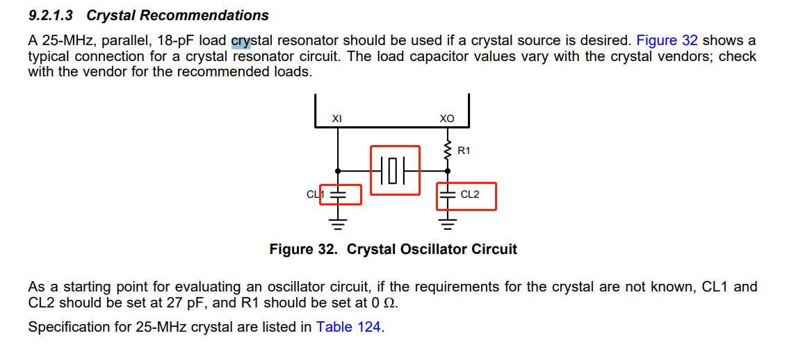

DP83867IRPAP, if I want to get the 25mHz crystal oscillator frequency, Can you help confirm the required parameter values of CL1, CL2, and R1?

Hi Elsa,
The capacitor values can be verified using the crystal datasheet. We also have application notes available for crystal selections.
