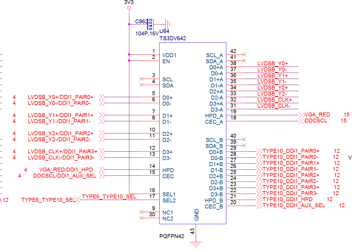

Could you help confirm whether the TS3DV642 can be used for VGA analog signal switching? thank you!

Please give me few days to look at the VGA specification to see if the TS3DV642 can meet the VGA requirement.

What I am not sure is the TS3DV642 impact to the analog signals’ linearity. It will degrade each RGB signals. VSYNC and HSYNC signals should be OK.

Regarding the linearity of analog signals, do you mean the voltage drop of the on-state resistance and its mismatch between channels? If so, do we have other suitable solutions for the application? Thanks for your support!
