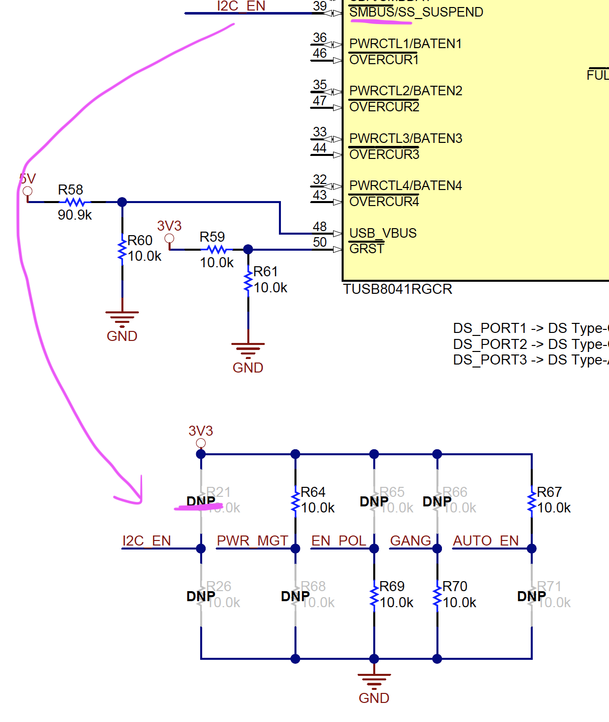

  • Hi Woojun,
    So the TUSB8041 does not require firmware or external configuration if you have SMBUSz pin pulled high.  Even if you plan to use a SMBUS or I2C host to configure the hub, can you try setting SMBUSz high just to confirm the USB data lines are routed correctly?

  • probably, I need to get SMBUS pulled high. it is DNP at the moment.

    actually, I've got a I2C EPPROM connected to the hub like below.
    in this case, so should I remove the EPPROM? or just leave it?

  • Hello Woojun,
    If you have a blank EEPROM connected to the hub, it should go into programming mode by default.  SMBUSz is floating or pulled high, correct?

    Yes, EPPROM is connected to hub and SMBUSz is floating now. I will try to have it pulled high soon by adding 10k resistor on DNP.
    At the moment, I can not see the hub in Device Manager USB section. it is not recognised.
    Do you think that the hub is going to be recognised when SMBUSz is pulled high?

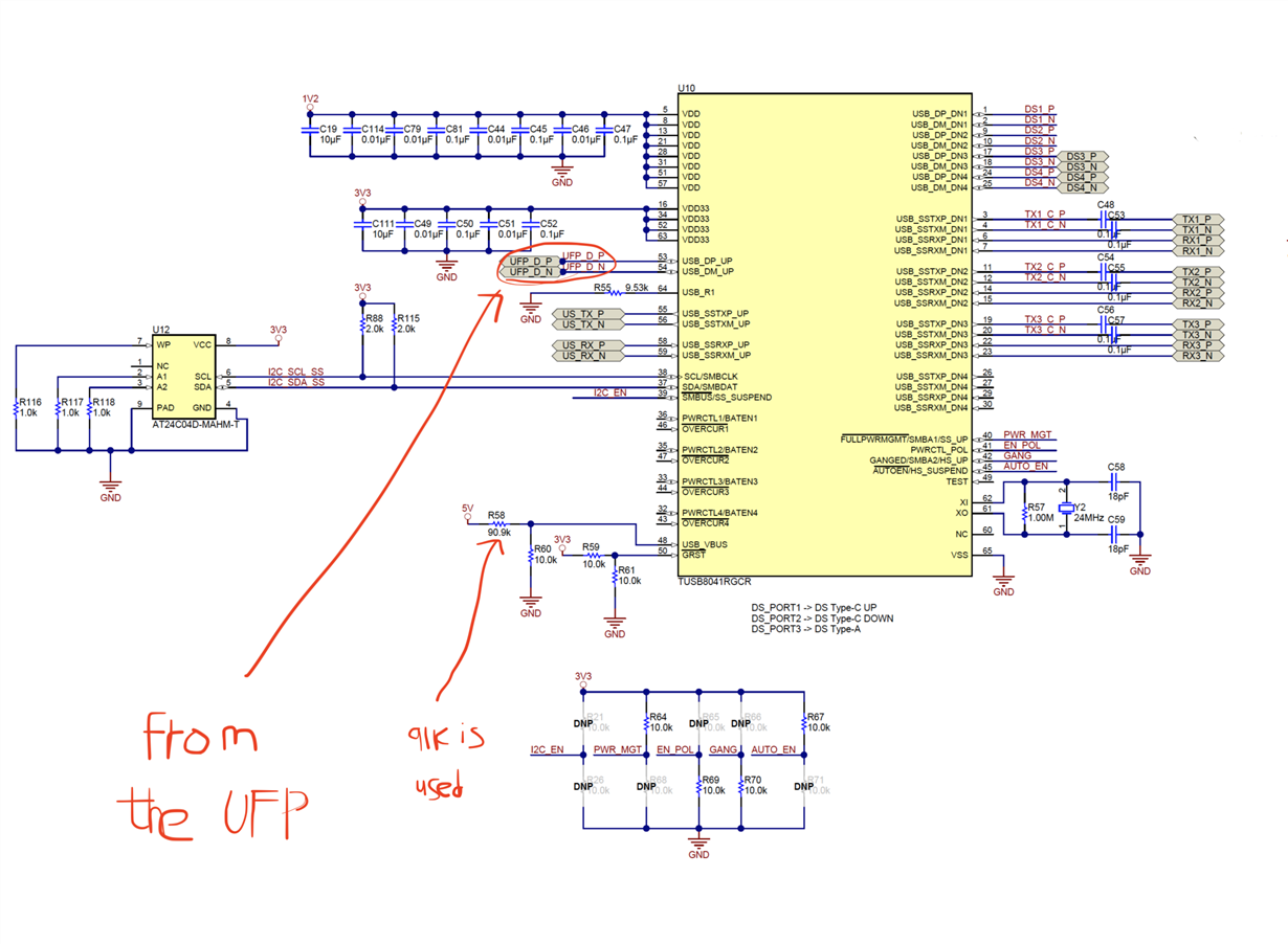

  • Hi ZMMN!
    Here is the schematic, which is basically almost identical to TIDA-03027.
    Upstream port & TUSB8041
    1.Yes USB_VBUS is high. but, 90.9k resistor is replaced with 91k resistor.
    2. GRST still has external pullup. I will update as you suggest. this might be the reason that the hub is not recognised?
  • Hi Woojun,
    Pleaser remove the pullup on GRSTz and replace the pulldown with 1 uF capacitor

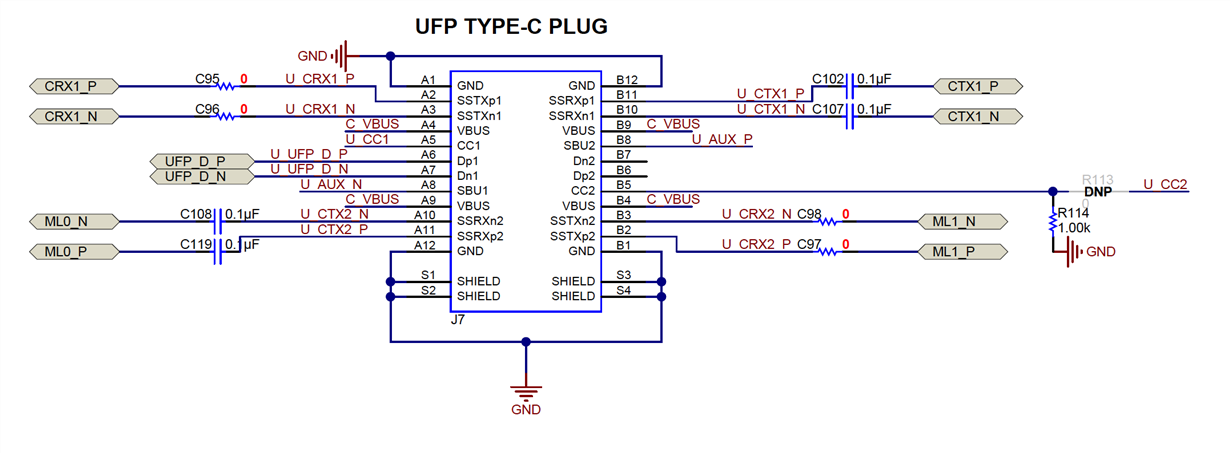

    I see a couple of issues on the Type-C port connections:
    Usually both USB 2.0 pin sets are shorted together on the Type C port ( pin A6 to B6, pin A7 to B7) so that when the connector is flipped is still works at USB 2.0 speeds.
    Also, you have the SSTX pins connect to the SSRX signals.  SSTX pins should be connected to SSTX signals (and SSRX pins to SS RX signals).

  • Hi ZMMN

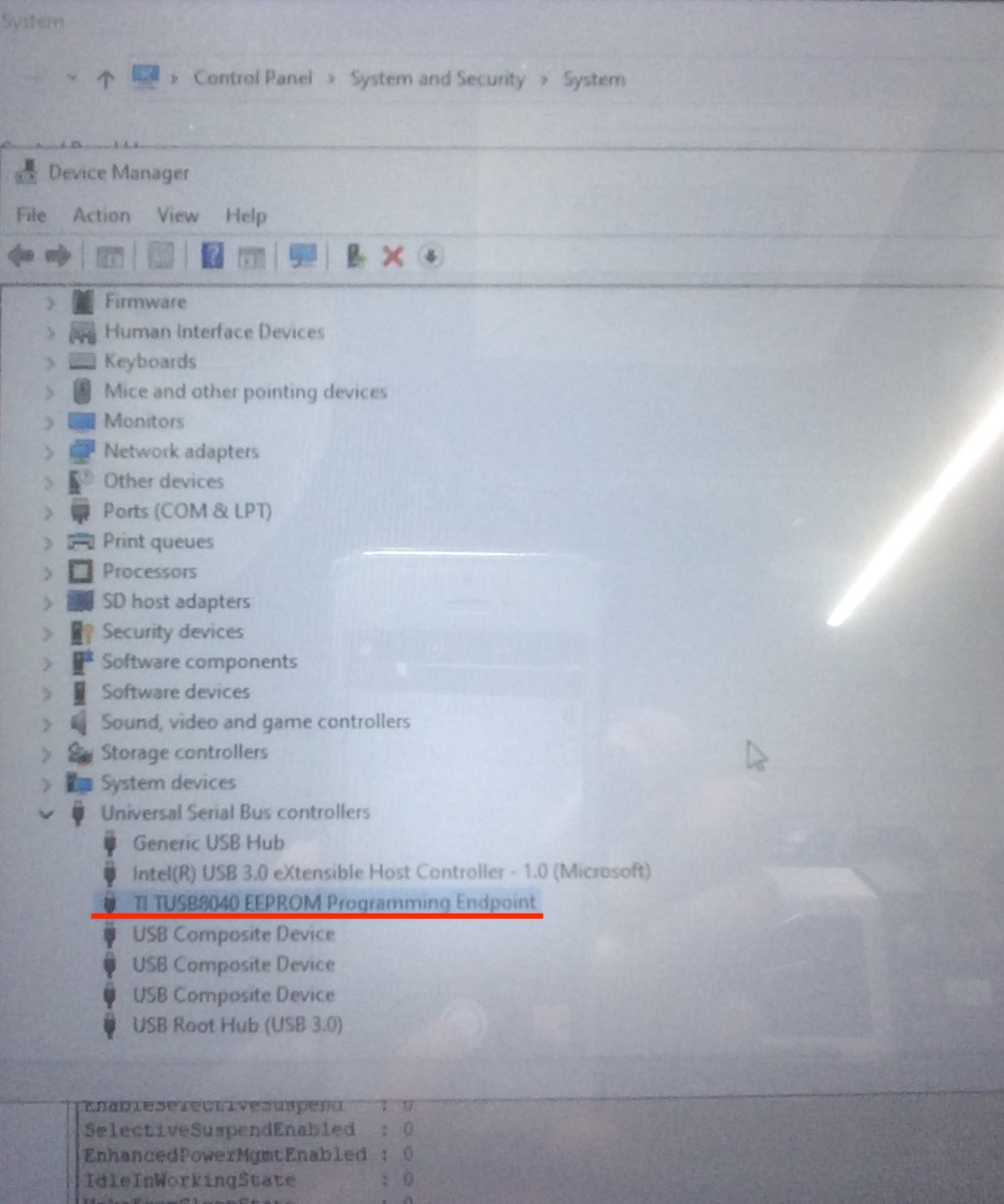

    I tried to remove the pullup on GRSTz and SMBUSz is now pulled high as you suggest.
    It seems like the hub is now recognised like below.
    1.is it normal that the hub is labelled as EPPROM programming Endpoint? Do I need to do anything more to get it work?

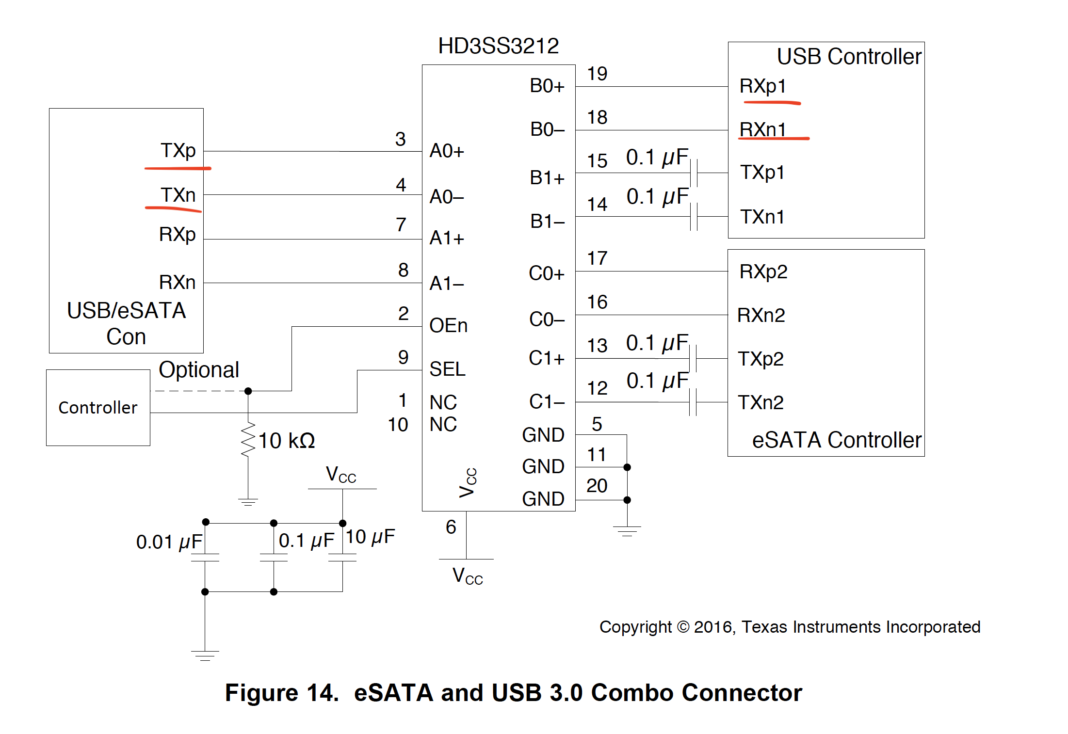

    3.  in terms of SSTX connected to SSRX,  the schematic I showed is original TIDA-03027.
     RX and TX go to  demux(HD3SS3212) in the schematic like below.
    The reason why SSTX pint is connected to CRX is because of DEMUX?  I'm curious.

  • Hi Woojun,
    Can you send me a link to the TI design you are using for a reference?  It was not done by my group and I'm not able to find the schematic online.
    I don't see where SSTX connects to CRX?  A0 will only route to B0 or C0, not B1.
    It looks like the hub still has a blank EEPROM attached.  You either need to remove the EEPROM or program it to prevent the programming tool from loading automatically.  If possible I would just remove the EEPROM for initial testing, it is not required.

    2)  I see. I will try to remove the EPPROM or programme it with the tool. hope it goes well.  good to know that the hub is in programming mode.
    3) Probably, this might be a different case. the pics below shows that TX goes to AO and goes out to RX via B0.
        Do you guess this application make sense? I'm a bit confused about HD3SS3212.

    I understand the reference design now, I missed that the Type-C connection is a plug, not a receptacle.  That explains why RX and TX are swapped since there would be no cable swap.  Thanks for sharing it.
    JMMN
  • Also, since this is a Type-C plug, the two DP and the two DM lines are not shorted together.  Apologies, I had assumed I was looking at a receptacle design.

    1)
    I think I made a mistake that I thought  the plug in the schematic is receptacle.
    so I will try to do something on USB-C cable to fix this problem.

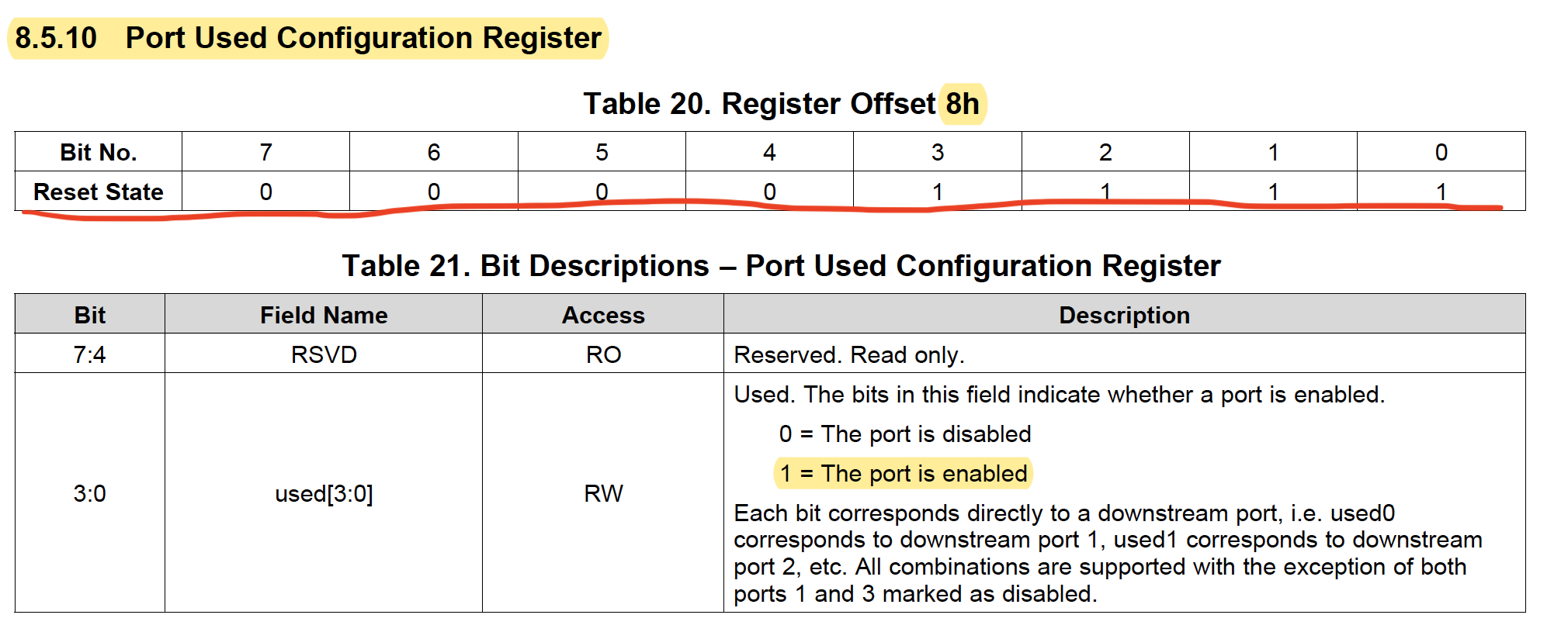

    I'm looking at the TUSB8041 Datasheet to programme. can I ask registers I must programme?  little hint might be great!
    3)
    From the data sheet,  is the reset state(on red line) a kind of basic setting for each register?

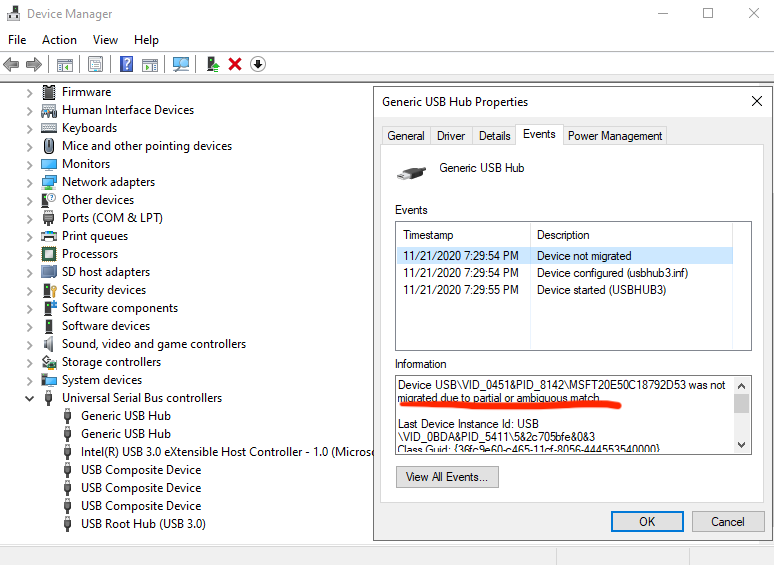

    I guess the issue above is not a big deal. I just want to make sure whether I can leave it or not.

  • Hi Woojun,
    That's an error from the driver side so I don't have any information on it, but if you don't see a yellow bang next to the driver it should be ok.  Can you confirm that you are able to see devices plugged in on the ports of the hub?  I would recommend downloading usbview.exe or USB Device Tree Viewer to get a good visual of what your USB connections are.
    Also, the hub is only connected at USB 2.0 right now, probably because of the TX/RX swap issue we discussed earlier.  Once you get that fixed you should see another hub entry for a SuperSpeed hub in Device Manager.
