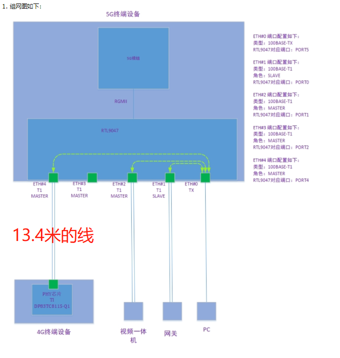

  • Hi Kevin,
    A poor SQI will to poor link quality and signal quality. This can cause errors and lost packets, including ping failure. What we can do is try to locate the source of the poor signal quality. What type of cable and cable length is being used? Can you provide a schematic for review?

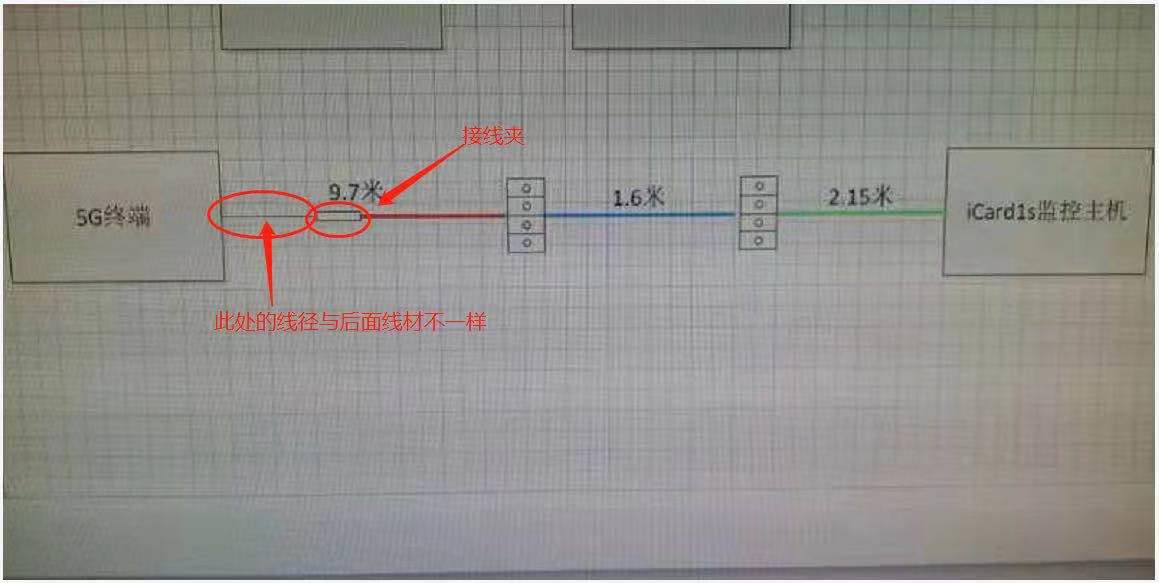

  • Nikhil:
    Use common double Jiao shielded wire, 13.4 meters in length
    Using the wire in Figure 1, the packet loss will be serious when the length is 13.4 meters, and eventually the Ping will not work.
    There is no obvious packet loss in the laboratory when using the wire rod of specification Figure 2, and there is no obvious packet loss in the real vehicle, but the actual routing has not been carried out according to figure 1

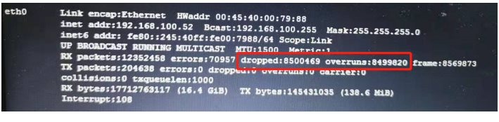

  • Nikhil :
    Thank you for your reply
    1。 what are the changes in conditions fir the setups with ping failure?
    As shown in the figure, when it doesn't work properly, we find a lot of errors and dropped through ifconfig

    Additionally, can you describe this setup in the picture below in more detail? Is it three lengths of the same cable model, separated by interconnects? If so, is SQI still poor for a short cable length with no interconnects?
