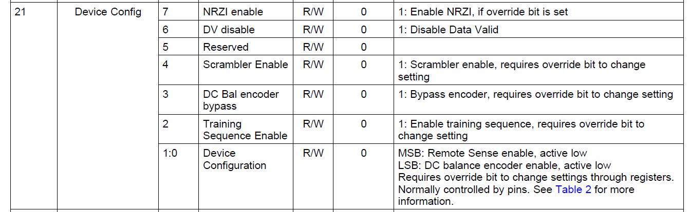

2. Address 21
Q3) What is Training Sequence of bit2?
Q4) What is the difference between disable (DC Bal encoder bypass) of bit3 and enable (DC balance encoder enable) of bit 0?
