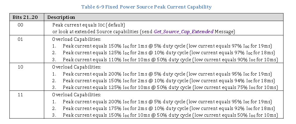

Hi TI,
I need to drive an inductive load at 3-3.5A, 20V, around 3-4ms duration, rms measured around 1A (20W). How will the TPS65982 respond to the peak current values if both the source and sink both use the TPS65982 with a 2A negotiated contract?

Hi Aaron,
The Peak Current behavior will depend on the configuration of your Source TPS65982. You can adjust the Peak Current in the Source PDO's from 100% to 200%. Since you have a 2A contract and need to pass through a 3-3.5A load, I would set the peak current setting for your 20V/ 2A PDO at 200% to pass this current through without triggering OCP.

Hey Eric,
This might be documented in the datasheet and I'm missing it, but the sink PDO would behave similarly, correct?
The datasheet states
"The current through PP_HV to VBUS is current limited to ILIMPPHV (only when operating as a source) and is controlled automatically by the digital core. When the current exceeds ILIMPPHV, the current-limit circuit activates. Depending on the severity of the over-current condition, the transient response will react in one of two ways: Figure 27 shows the approximate response time and clamping characteristics of the circuit for a hard short while Figure 28 shows the approximate response time and clamping characteristics for a soft short of 7"
So, the sink doesn't power limit. However, I can set a sink PDO peak current in settings--does this mean the sink PDO peak current would be used by the source? Which value would the source limit by?
In other words, if my source is set to 200% peak, and my sink is set to 150% sink, the peak current before OCP would be 150%, but because the source would then limit the current to 150% correct? Or would it be 200%?

Hi Aaron,
I'm assuming you're using a 45W Type-C adapter that is offering 20V/2.25A to the TPS65982-EVM that you are using. Although you set your source PDO to sink only 3A, it will still accept lower contracts. In this scenario, the capabilities mismatch in the PD communication will be set to 1:
You can find more information about the capabilities mismatch in the USB PD Spec.
