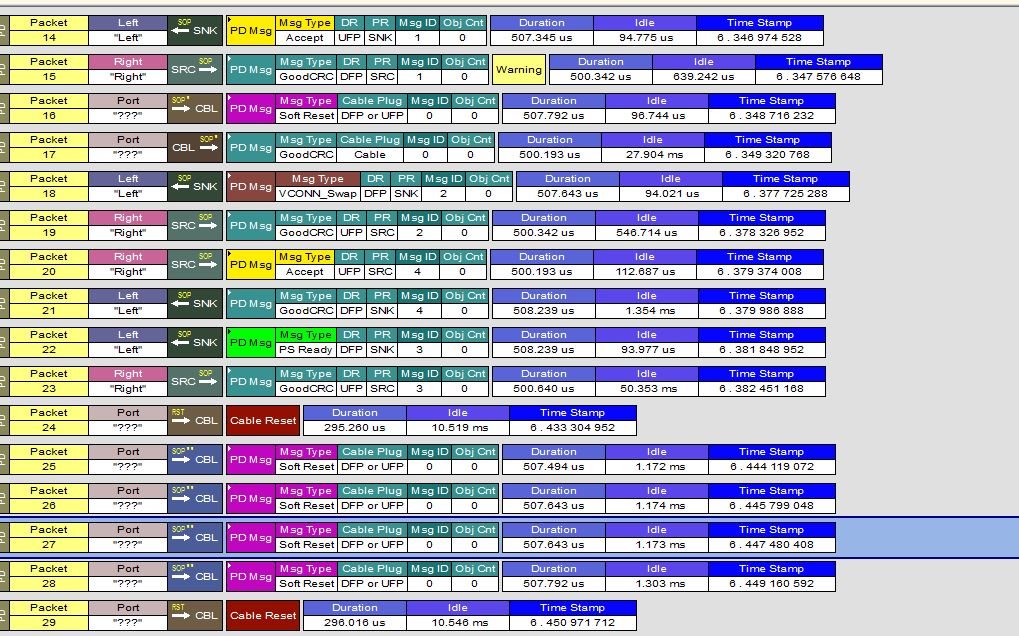

 My customer use TPS65983B to design a type-c dock with cable. There're different condition by using different FW with similar setting:
1. 982 base FW: It works good with Yoda in FW version 1.12.0 or later.
2. 983B base FW. I test FW 1.38.01 and 1.38.02. They have same result: sink side's soft reset command is responded by source in stead of by cable ( 983b is sop and sop' host) and the connection is really break...
Please help to check the pjt and give me suggestion what I should modify in my setting. Thanks.

    We test 983B v.1.31.04 FW and it works correctly. Please check the sop' response message.
    Please help to check what's the different between those version of code for SOP' process. Thanks.
