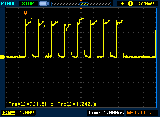

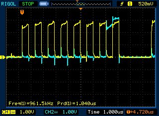

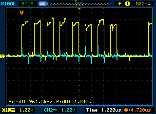

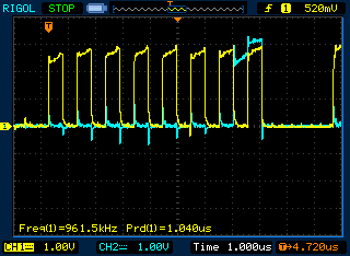

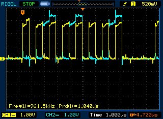

Could you please provide some guidance on how resolve the following issue we are experiencing?
We have a TXS0108E IC to switch logic levels from 1.8V (Qualcomm Snapdragon 410) and 3.3V (STM32F100) and are having issues with many byte errors happening in the SPI communication.
The Qualcomm is the master and the STM is the slave. The SCLK is running at 1MHz (the TXS0108E's datasheet specifies that speeds up to 60Mbps should be doable for push-pull).
The TXS0108E is in the "vicinity" of the Qualcomm processor, and the STM32 is on the "far end".
We wrote some quick programs to send incrementing numbers out of the Qualcomm and be echoed back by the STM.
The result of this test is: approximately 60% of the bytes came back with errors. When we hooked up the oscilloscope the error rate became significantly larger, over 80% (the probes were set at 10X).
As you can see, transitions look fast but DC levels look bad. There is also some crosstalk and ringing.
Please refer to the following images:
Picture references:
SCLK is yellow
MOSI is blue
The oscilloscope probes were set at 10X
60% byte error rate without the oscilloscope
80% byte error rate with oscilloscope

  • Hi Alessandro,
    Thanks for your post and the detailed explanation.
    TXS supports 60Mbps push-pull interface, however, it is also under limitations of the output loading.
    Output loading could be in the form of parasitic capacitive loading, output current loading required by the receiver device (STM in this case).
    When you start to probe the IO ports of the TXS, it introduces additional probe capacitance which is indicated by the error rate increase, as you have mentioned.
    Especially if there is a fan out of the SPI signals into different slots, I would not use this TXS0108 device which provides no more than 20uA of DC drive through its  internal pull-up resistors.
    I would instead suggest using the SN74AVC4T774 which has individual DIR control pins to control the signal flow and suit it for SPI interface. It also provides enough DC drive 12mA per channel to fan out the signals to all the expansion slots as well.
