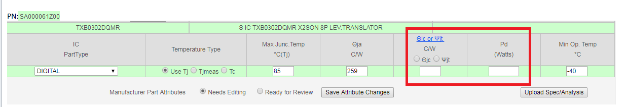

I would like to know the Cita Jc of TXB0302DQMR
