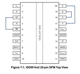

Is there a connection scheme for this part (or other full duplex parts) to emulate a half duplex part? (ie interconnections between A,B,Z,Y, etc.)?

Below figure shows the connections to use a full-duplex RS-485 device as a half-duplex device.
You can also refer to section 11.1 of the datasheet for additional information.
