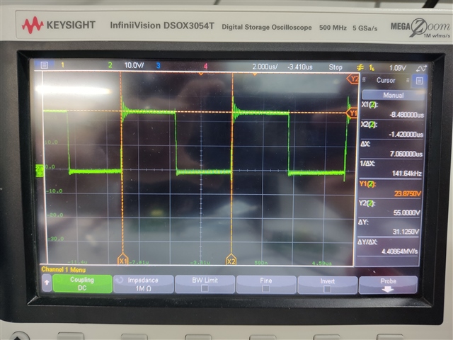

    Regarding the waveforms you asked, first here is the waveform of the drain to ground with the original transformer of the EVB with freq of 1MHz and duty of 20% and with load of 150ohm (Vout was 4V like the formula):

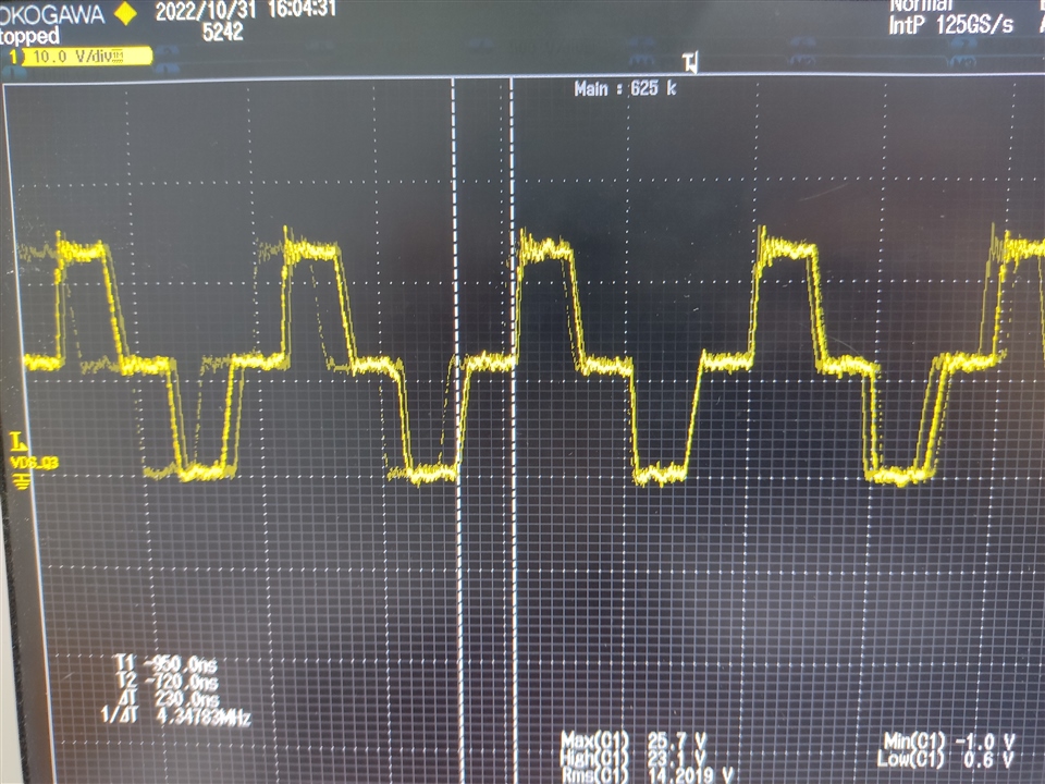

    This seems good like in the books, but if i remove the load i get this:
    I think that the Coss capacitor of the mosfet is charging slowly without load at the output.

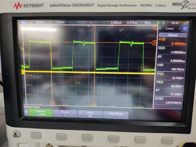

    Then, i placed my transformer with 150kHz and 30% duty cycle and with load of 1.7kohm (Vout was 80V when from the formula it should be 50V in 30% duty cycle):
    This not seems like the first picture..

  • Hi Maor,
    Thanks for sharing the waveform, this helps.
    The first waveform is good and I believe that looks accurate for switching waveform with much lower duty cycle than 48%.
    The second waveform should also have looked like the first one ideally but since there is no load, the energy stored in the transformer is not being discharged and hence, it slows down the change in voltage. This is probably causing the voltage across MOSFET to appear changing linearly.
    The third waveform looks accurate for a switching waveform with 48% duty cycle. This is also the reason why you are seeing 80V which matches with an expected voltage of 84V for a transformer with a turns-ratio of 7 and input voltage of 12V. I would appreciate if you can share all the information related to this particular waveform or test setup so that I can confirm why the duty cycle is not changing to 30%. Information that I am looking for is,
