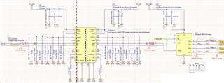

We are using the ISOUSB211 in a design. We are only using the ISOUSB211 for the isolation of the DD+ and DD- lines. Therefore, it does not have an isolated power supply and shares the same ground.
The upstream-facing port will be connected through a USB connector to the PC. The downstream port has a USB switch behind it. Upon insertion of the USB cable, the switch first connects to a battery charging IC. After determining the charger type, it switches to a processor module (i.MX6ull) for data communication.
The problem I'm facing is that the isolator does not allow any USB communication through. I understand it's an isolator, but this isolation seems excessive.
Here's what I've verified: All power supplies (VBUS, V3V3, and 1V8) are present on both sides of the ISOUSB211. Additionally, both VxOk are high on both sides.
I also purchased the development kit (ISOUSB211DPEVM) and recreated the same configuration on it. The configuration works fine on the development kit.
I bypassed the ISOUSB211 to rule out any issues with the USB switch, etc. In this case, it works fine, indicating that the ISOUSB211 is not functioning correctly.
I'm at a loss. Any advice on how to proceed? It seems like it should work, but it doesn't.
I've also noticed that the ISOUSB211 has functions like Connect and speed and disconnect detection. Could these functions be causing problems due to the switching of the USB lines?
Any help would be appreciated.

  • Hi Hielke,
    Thank you for sharing the schematic.
    I reviewed the schematic and I couldn't find any obvious issues in it. When a USB device is connected, they go through a handshake to recognize each other and align on speed. If the connection is dynamically changed through a switch, the handshake gets broken in-between. I am not sure if such switching would allow for any communication.
    USB requires that a peripheral once connected stays there till the communication is ended. If disconnected and then reconnected, it will go through a new set of handshaking. But in your case, switching the connection dynamically doesn't make ISOUSB recognize this as a new connection and will fail to initiate a new connect sequence.

  • I want to let you know that I solved the problem. It had nothing to do with the ISOUSB211. The ISOUSB211 worked fine, and the switching of the USB lines also works.
    The problem was the buck-boost converter that generates the 5V_USB from the input power. The voltage sagged when the USB-communication was started, probably resetting the ISOUSB211.
    The reason for the voltage sag was that before the buck-boost converter, there was a fuse with a cold resistance of 7 ohms. The voltage drop across this resistor was too great for the converter to handle.
    To fix it, I needed to either decrease the cold resistance of the fuse (another fuse) or add more capacitance to the input of the buck-boost converter.
    So again, the switching of the USB lines works fine, and the ISOUSB211 was not to blame.
