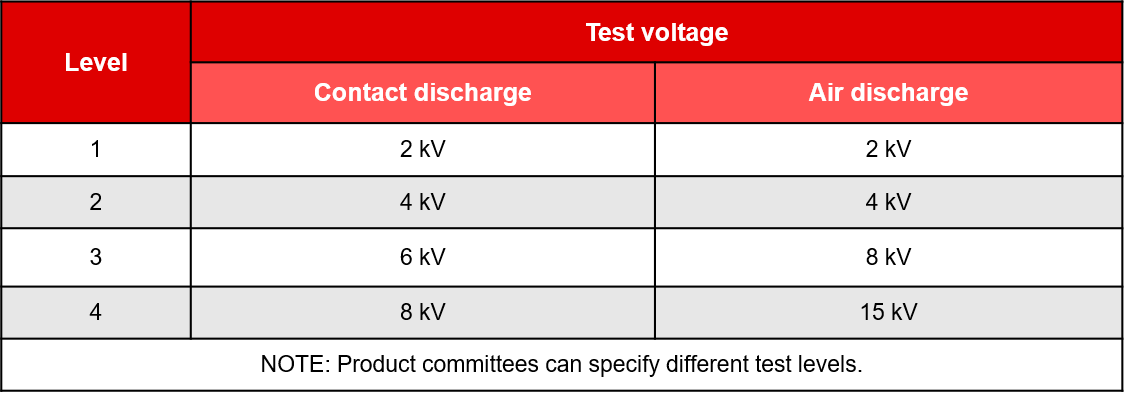

    Test level
    The ESD immunity test is conducted successively at levels 1-4 with the option of adding additional levels above, below, or in between the others. Level 1 represents the lowest required test with a contact discharge voltage of 2kV while level 4 represents the highest with a voltage of 8kV. Additionally, the test can be conducted in different mediums such as oil and air.

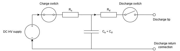

    Simplified circuit of ESD generator
              Rc – Charging resistor                                                     Cd – Impulse duration shaping resistors
     Cs – Energy storage capacitor                                        Rd – Impedance matching resistor

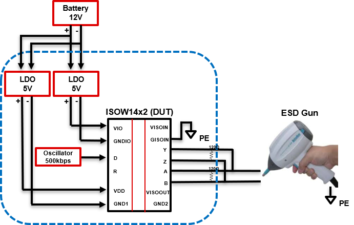

    Example schematic of ISOxxxx under test:
    Test Results
    The results are evaluated by the performance level defined in test levels section above. They will be provided with a pass level, the medium it was tested in, the stress type, and the contact type:
    Across Barrier:
    ISOxxxx passes level 4 in oil using contact discharge
    or…
    Across Barrier:
    ISOxxxx passes ±8kV in oil using contact discharge
    Which means, ISOxxxx withstood ±8kV strikes without any loss of function or degradation of performance.
