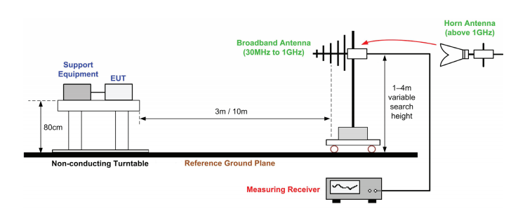

    Test setup & procedure
    Setup for RE tests above 1GHz and below 1GHz
    The DUT is placed on a non-conductive table within the uniform field area at a height of 0.8(±0.05)m. For low frequencies (30MHz – 1GHz), the antenna is set 10m away from the DUT with a piece of anechoic material separating the two. The antenna is configured for horizontal and vertical polarizations and is adjusted in height between 1m – 4m with step size of 1.5m. For high frequencies (1GHz – 6GHz), the antenna is set 3m away from the DUT also with a piece of anechoic material separating the two. The antenna is configured for horizontal and vertical polarizations and is adjusted in height between 1m – 2m with step size of 1m. This setup can be seen above.

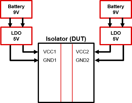

    Example schematic of ISOxxxx under test:
