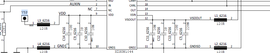

we are using 4x ISOW1044 in our design. We are facing noise issues on our +5V supply (80 to 100mVpp). Since the +5V supply rail is also used for other noise sensitive application we would like to minimize the noise. The ISOW application circuitry follows the recommendatations according datasheet so we have the ferrit beads and the capacitance on VDD pin:
Our +5V regulator is a buck converter with total 4x10uF output capacitance and a small ferrit bead at the output. I guess that the noise we observe are not from our 5V converter since the ripple signature is more or less random.
Q1: what are the recommendations for the driving supply? Do we have to add bulk capacitance and how much?

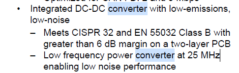

Q2: What is the frequency of chip internal isolated DCDC converter? Datasheet states in Feature section::
To be honest 25MHz seems to be a quiet high switching frequency.
Q3: Can you confirm the 25MHz switching frequency of internal DCDC converter?

    Yes, internal switching frequency integrated DC/DC is around 25MHz but the ripple that you measure at the common VDD supply will not have this frequency component as it gets filtered out by the local capacitors. If you measure the ripple frequency it should be in the range of 100s of kHz which corresponds to the regulation of the power supply.

    Thanks for feedback and recommendations. Unfortunately schematics design and PCB layout are fixed and we cannot introduce the LDO or another DCDC converter for ISOW VDD. Last questions to my issue...
    According datasheet and EVM there is VDD decouplked with 1x10uF, 1x 1uF and 1x 10nF. We can replace the 1uF with 10uF (same package).
    Q: Does this (2x10uF + 10nF) fit with decoupling requirements for ISOW VDD? According datasheet bulk capacitance >= 10uF and the 10nF is required. I guess that the 1uF in the middle is to provide broadband decoupling.

  • Hi Andreas,
    We would not recommend removing 1uF as it can filter the higher frequency 25MHz noise more efficiently due to a higher SRF compared to 10uF.
    You can definitely experiment it out as well and see if it reduces to your requirement, but replacing 10uF with higher value such as 22uF or 47uF sounds more effective.

  • Hi Varun,
    What about ferrite bead selection for VDD filter? Actually we use a type with Zmax=120R (package 0603). In datasheet PCB layout section a recommendation with BLM15EX331SN1 is given for the Visoout only. In EVM a bead with 1500R is used for VDD power filtering:
    Do you see there any improvement with higher Z?
    I think the observed ripple is below 100khZ and the bead Zmax is normally spezified for 10 to 100MHz. So, I would not expect an real improvement in terms of ripple reduction.

  • Hi Andreas,
    The ferrite beads used in EVM are meant for high frequency noise suppression.
    Since the ripple is in 100kHz frequency range, the ferrite beads impedance would not be effective - as you already mentioned above
