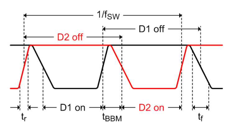

  • Hi Koteshwar,
    From the data sheets of ISO1176T, the absolute maximum rating of the transformer driver output current, ID1 or ID2 is 450 mA. Is it the peak current at 350KHz or the max continuous current? What is its recommended peak current at 350KHz? If the peak current of ID1 or ID2 at 350KHz is 300mA, for example, do this mean that it can provide 300mA DC on average on the primary side of the transformer used in the typical application shown on page 1 in the data sheets?
    Many thanks and kind regards,
    Bailin
  • Hi Bailin,
    As you may already know. D1 and D2 switch ON and OFF as below. Both are never ON at the same time.
    The absolute maximum of 450mA shows the maximum amount of current that can flow through either D1 or D2 when respective drive pin is ON.
    If peak current is 350mA at 350kHz, then 350mA can flow through D1 when D1 is ON and similarly it can flow through D2 when D2 is ON. The IC will be able to drive a continuous load of 350mA.
    Hope this answers your query.
