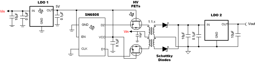

The SN6501 has a maximum input voltage of 5.5V. I am looking for simular  Transformer Driver for Isolated Supply with 12V Input (100 mA).
  • Hi Lothar,
    Welcome to E2E! Unfortunately, we do not offer a transformer driver with input voltage >5.5V at the moment.
    We propose using external components around an SN6501 or SN6505 as shown below to build an isolated supply where Vin is 12V:
    Is this a possible solution for your system? Please let us know.
