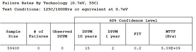

[FAQ] ISO7041: What is the FIT data for this part?
