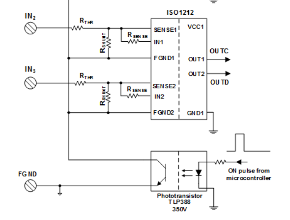

I'm looking for a solution for the relays contact weld detection
The solution from TIDA-010071 looks good, but I have a question:
What will be power dissipation on resistors R71, R72? (Considering 240VAC input)

Hi Kostya,
I apologize for not understanding; you'd like to reduce power consumption without affecting ISO1212 threshold values, correct?
Thank you,
Manuel Chavez
Hi Kostya,
Turning field inputs ON/OFF using the optocoupler as you have shown above will reduce power consumption significantly. A series RC circuit can be used to attenuate the AC input without dissipating as much power as the 60kΩ resistance. The capacitor would need to be rated for 240VAC and tuned ~55nF (with R = 10kΩ) to yield similar thresholds.
If you'd like to minimize power consumption in each 30kΩ resistor specifically, they can be divided into a total of four 15kΩ resistors each dissipating ~97.5mW.
Please let me know if you'd like to pursue one of these suggestions.
Respectfully,
Manuel Chavez

Hi Manuel,
Thank you for idea with a capacitor. But I will probably stick to the optocoupler variant. Properly rated X2 capacitor will take to much space on the board and I have very limited space in the current project.
Thanks a lot.
