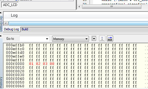

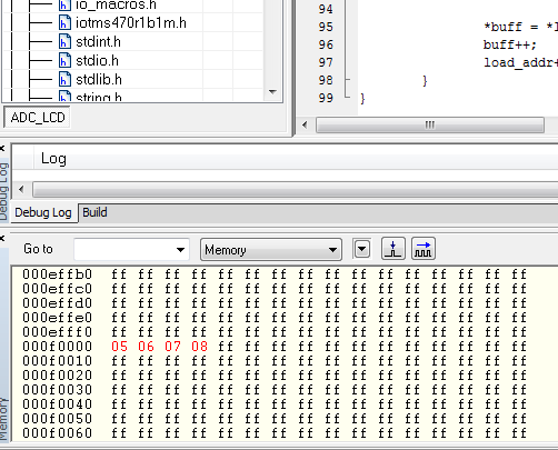

  • Hello all,
    I am trying to save some values to SM470R1B1M internal falsh. I am using IAR compiler and fallowed the steps mentioned in this post.
    I am successfully able to write and read as well.
    I have a problem with rewriting. If i rewrite into the same address location then the new data is not writing?
    Do I need to erase to rewrite into same address location?
    I have erased and re write into same address location using erase function from  FlashSM470R1B1M.c file. i am able to erase previous data but  i am not able to write last address.
    for ex: if i write 0x000f0001, 0x000f0002, 0x000f0004 and 0x000f0006 locations then when i erase and re write into same locations then it is not re writing into 0x000f0006 location but remaining three locations it was updating. In th final location it was showing 00 the data.
    first write 05, 06, 07, 08
    After erase and rewrite 01, 02, 03, 04.
    Can anyone suggest me how to rewrite to same location without error? or Do I need to erase to rewrite ?
    veeru.
  • Veeru,
    Flash technology requires an erase to the sector or segment that is being written to.
    An erased flash is all 1's. Writing to device can only program a 1 to a 0.
    Attempting to program a 0 to a 1 will not work, and should generate an invalid data error.
