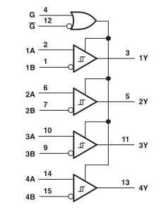

AM26C32-EP QUADRUPLE DIFFERENTIAL LINE RECEIVER
Can someone please help me understand the logic diagram here? To my understanding...what looks like a tri state buffer...is a digital comparator...taking the a signal and it's complemented form's differential and outputing the result...but what exactly is the or gate with Enable/Disable for...? I know my logic like any other EE, but what am I missing here?
