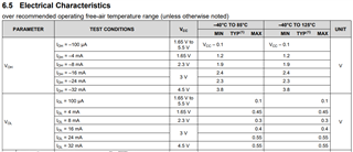

At 3.3V operation, to keep V_OH above 2.3V the output current needs to remain less than 24 mA. To ensure this, use Ohm's Law to calculate resistance:
R = V/I = 3.3 / 0.024 = 137.5 ohms
RL should be larger than 137.5 ohms.
