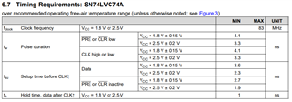

    I wanted to also bring up a recommended improvement to the frequency divider circuit being used with the LVC74.
    From the timing requirements table of the device:
    Note that the hold time is 1ns, which means that the data input needs to be held for at least 1ns in the previous state after the clock pulse occurs.
    As it is shown above, the circuit will probably be fine, however I would recommend a simple addition to ensure reliable operation under all conditions.
    Just adding a resistor, typically 100 ohm, will add sufficient delay (using the input capacitance for an RC circuit).
