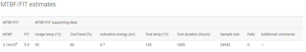

The potential failure modes of any of our logic devices are the same -- open, short, or resistive short (partial short)
We can provide the mean time between failures (MTBF), or the failures in time (FIT) -- both of which are available in the product folder for the device. Please see the FAQ below for details on how to get to that data.
It sounds like you're in need of a functional safety report.
My apologies - the FAQ I originally linked is only internal because this is the kind of request that must come from a TI field team. Please contact your sales representative for TI to request a Functional Safety Report.
If you don't have one of these, please contact our customer support team so they can help you get in touch with your local sales reps for TI. Here's the customer support page: Customer Support Center
