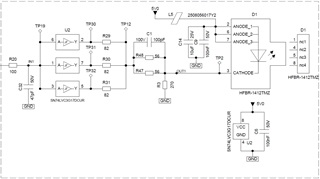

We are using SN74LVC3G17 as driver for optical transmitter. The current is almost 24mA each channel.

  • Hi Deepak,
    Can you send me a schematic of your circuit? Specifically I want to see what the load is.
    Are you also able to send a more zoomed in scope shot of this?
  • Thanks for response.
    Above is the snap of the schematic which shows the load being driven by the buffer- HFBR-1414TMZ.
    Below is the zoom Version

  • Hi Deepak,
    Try adding some capacitance to ground at TP30, 31, 32. This will slow down the the rising edge on the drivers which should smooth out the input to HFBR-1412TMZ and eliminate the overshoot. 15 pF may be a good starting point and you can increase it to see if the signal will react better. 70 pF is about the max I would recommend.
