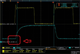

Pls help to review the LSF0102 design and waveform.
Support need
1.Schematic review:
Comment of why the low voltage level on B1 side.

  • Hi Eric,
    The low output voltage of an LSF translator will be a combination of the input low voltage to the LSF0102 and the voltage drop across the device due to the current sinking through it. This is explained in detail in this video: Up Translation with the LSF Family
    Most likely, the customer has a relatively low pull-up resistor value that is causing a large amount of current to sink through the device. The pull-up can be increased to reduce the current, but this will also slow down the signal's rising edge, which seems to be pretty fast currently. I expect that they could get away with about double the resistance while still maintaining the shown data rate without any problems, which should cut the VOL value down significantly (by about half).
