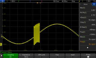

We are using the TXS0104EDR for voltage translation of SPI signal
VCCA side we are supplying 3.3V and VCCB side we are using 5V  ,Below is the schematics reference .
SCK and SDO output signal of SPI at the pin 13 and pin 12 of the IC (U1) is not as expected , we didn’t get the translated output , I have attached the waveform image for the same.
Kindly suggest to solve this issue

    here with i have attached separate waveform for SPI data/clock  input and output waveform SPI clock input SPI data input and output waveform
    in the attached waveform , IC output at somepoint seems to be 5V and 3.3V , Similar for both the waveform .
    kindly suggest a solution for the same

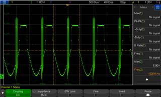

    I have removed the external resistors. Now there are only two decaps (0.1uF/16V), one pull-up resistor (10K) for OE (pin#8). A square wave input was given from function generator, but there is no proper voltage level translation. Also I could see spikes in the output waveform. Please see the waveforms attached. The yellow color waveform is input and green color is output.
    Any suggestions please.
  • There is no proper voltage level translation because the input does not have proper voltage levels. The input signal must go near 3.3 V.

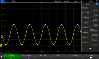

    Input voltage level increased to 3.3V, now I am getting voltage level translation to 5V. But I am facing another issue. If I connected my input source to the level translator board noise is adding up. Any idea why this is happening? Please see the attached waveforms.
    Input source before connecting to the level translator board
    Input source after connecting to the level translator board
    Noise in the Input source after connecting to the level translator board (zoomed image of noise area)
    Output of level translator
    Combined waveform - both input and output
  • Hey Noel,
    This is a digital device and you really shouldn't be applying a sine wave to the input. It should be a square wave with fast transitions. You are violating this spec:
    Doing so can lead to oscillations which is what you are seeing (this isn't noise).
  • Hi Dylan,
    Thanks a lot for pointing out that information.
    I have checked with a square wave as input, that is working fine.
