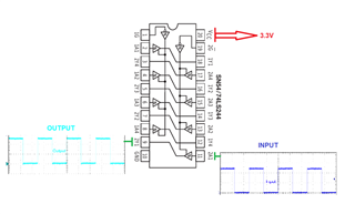

I have the following Buffer IC from TI 74LV244 below. How I check whether the chip bad or damaged or data is passing through? Any help direction would be greatly appreciated

Hi Clemens,
Thanks for the reply. Do you think I could use the changing signals as Vcc and GND as input and check the outputs
WJ
Why would you want to power down the chip? And GND must never have a larger voltage than any of the other pins.
Hi Clemens,
This is what I was hoping to do, Would this be a problem? any additional ideas would be greatly appreciated
Hi WJ,
All inputs that are unused should be terminated at VCC or GND when you're testing. Unused outputs should be left disconnected.
You need to pull 1OE\ and 2OE\ to GND to activate the outputs (unless you want to test the high-impedance mode -- it looks like you don't).
Your input signal should go from 0V (low) to 3.3V (high) if the supply is 3.3V.

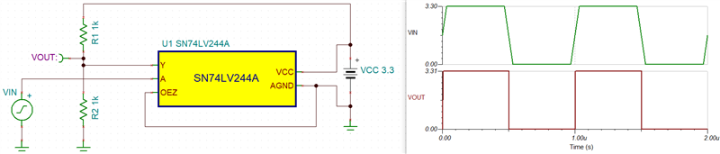

You can load the output with a 1kohm resistor divider to see if the output is weak - a weak output will not be able to drive all the way to the rail. I have attached an example circuit in a Tina-TI simulation so you can see the expected operation.
Emrys,
Thank you for the Tina-TI simulation, I have never used the Tina simulation before. The example has been very helpful. If it's not too much trouble, I have tried to use the .TSC example with Tina, but I was having difficulty displaying the graph. Would you show me the setup that you used for the Transient? (Analysis >Transient > start Display = 0 > End display = 2uS) > click OK.)
WJ
Just opening the file and running Transient Analysis works for me. What exactly is your difficulty?
