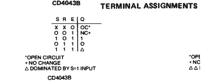

Hi Team,

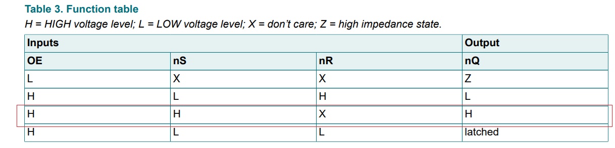

may we ask if the truth table of these two are functionally the same? our CD4043B truth table is below, can the CD4043 truth table fully replace the ocmpetitor version?  because after replaceing it with the CD4043B, the cusotmer system is reading incorrect value.
in attition, what does "dominated by S=1 input" mean for the CD4043B? does it mean that it is completely controlled by S input?
comprtitor truth table:
