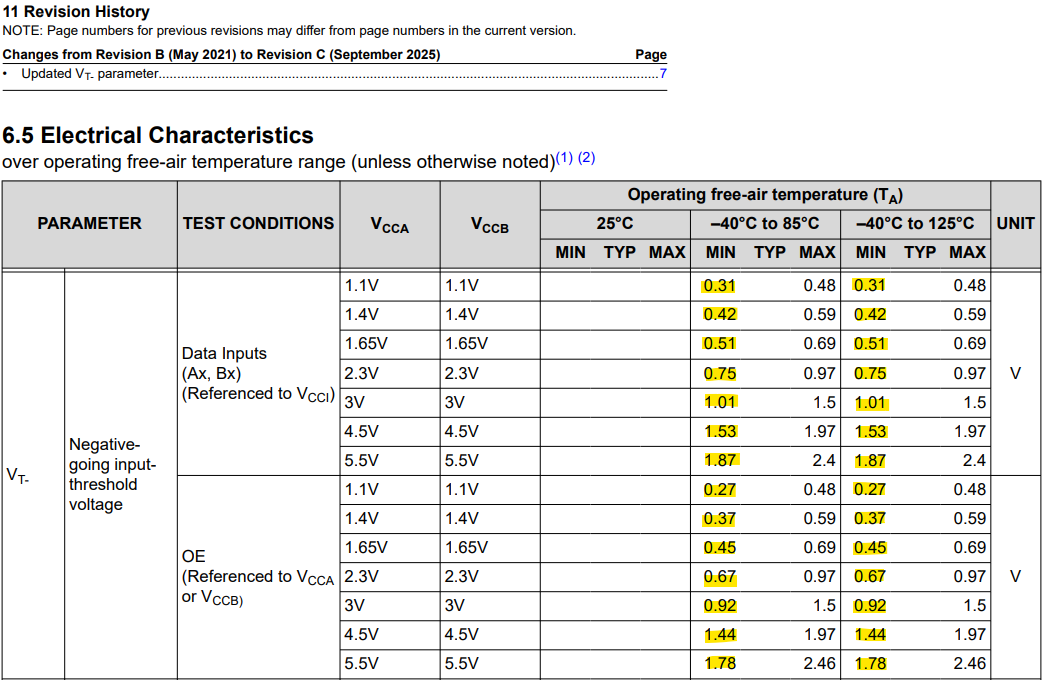

Recently, the PCN of TXU0304-Q1 has been issued, and Datasheet has been updated to Revision B→C.
ti_202510290010_11032025_.pdf
The attached PCN contents are as follows.
The updated VT-parameter of Revision B and Revision C of Datasheet has been changed as below.
[Revision B]
[Revision C]
The PCN contents have been informed to the customer who is currently using TXU0304-Q1, but the customer is requesting TI to confirm.
Q1) The VT parameter values ​​have changed, but why has only the datasheet been updated, while the IC components remain unchanged?
Q2) Is the VT-parameter value of the existing data sheet incorrectly measured?

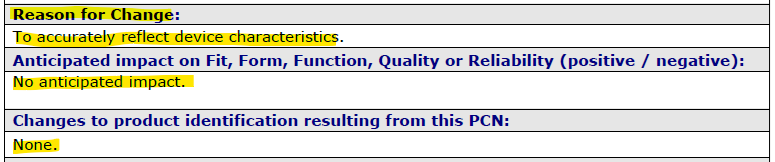

Q3) VT-parameter value has been changed, but why is there no anticipated impact as below?

  • Hello Grady,
    1) No architecture changes have been made to this part. This PCN document was intended to adjust the Vt- margins.
    2) As I mentioned above, when we initially created this part, the Vt- values had additional margin. What we did with this PCN is removed the Vt- margin.
    3) No die changes have been made to the part. If you are using the part before, you can continue to use it without impacting your system.
