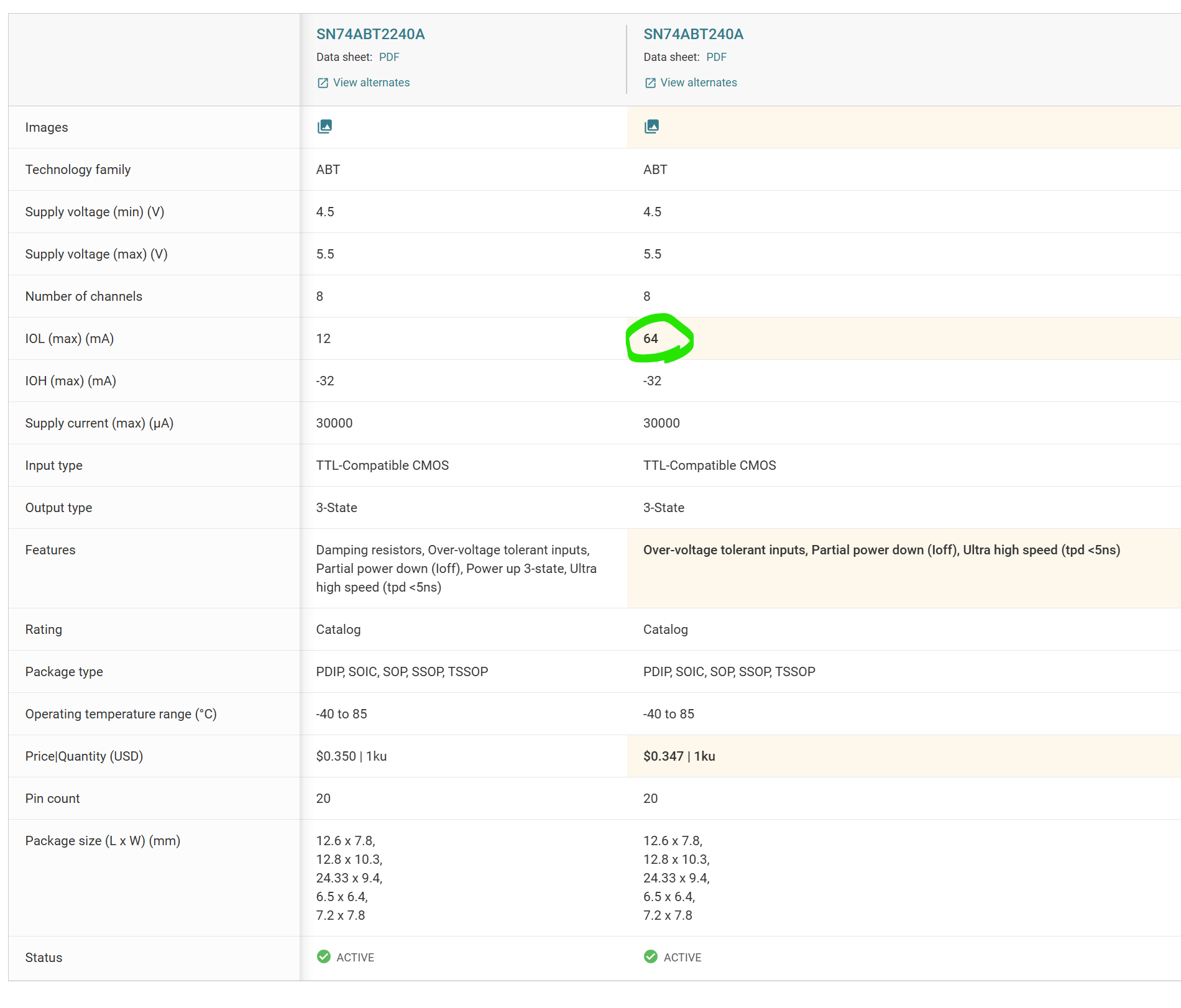

Part Number: SN74ABT240A
Team, Are both p2p compatible as below comariosn show? It looks only IOL is difference.
Besides, is there recommended one? thanks.

Hi Brian,
These are P2P compatible. The difference is that the SN74ABT2240A has a 25ohm series resistor on each output integrated into the device, hence the reduced drive strength.
